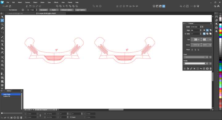

No matter whether you modify the path color or the fill color of the figure in the box below, this object will disappear. Please check what the problem is.
0_1728013887323_8.vstyler Select any group of graphics here. If you ungroup it twice, they will all disappear.

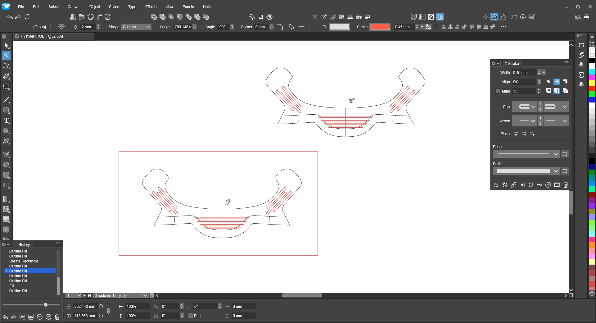

I think your problem is that you have a corrupt shape of some sort.

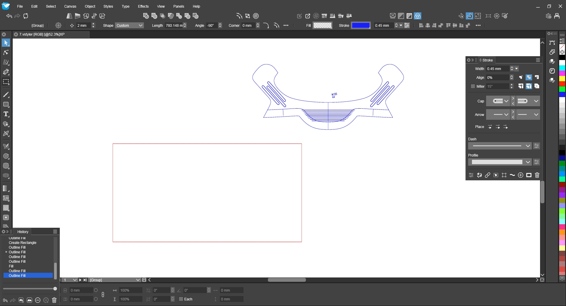

It seems as if the outer shapes are references of one another because if you hide the outer shape in one group, the outer shape in the other group also disappears - and vice versa.
Also, the outer shape of the object on the left is corrupted somehow. If you select the outer shape and switch to the Node Tool, you can see the hilited nodes are not following the path. They are off path. However, if you examine the outer shape of the object on the right with the Node Tool, the nodes are ok. They follow the path.
So if you delete the entire object on the left and simply duplicate the object on the right, now you will be able to ungroup them twice without any issue.
Were these imported by any chance from a CAD program? I think one way or the other the left shape got corrupted and that's why the error happened.
