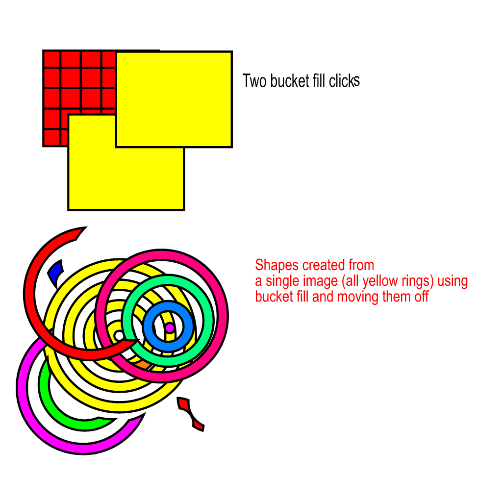

    In this case the 'Concentric Circle' tool was being used. Once drawn out you can colour every other row by selecting a colour. All well and good, you can move it around and resize it etc. Using the bucket tool you can colour individual rings, which I did.
    Using the transform tool to move the coloured ring set about resulted in a single ring detaching from the set (leaving the set unchanged). I was able to remove all the rings, recolour them with the bucket tool and remove them too - leaving the original untouched. Using the node tool I can reshape any given ring and detach it, again leaving the original intact.
    Using the grid shape, I tried to bucket colour the separate cells, but this coloured the whole square obscuring the grid, but you can move the coloured square off, leaving the original behind.
    I attach a picture of what I mean. Is this what is meant to happen?

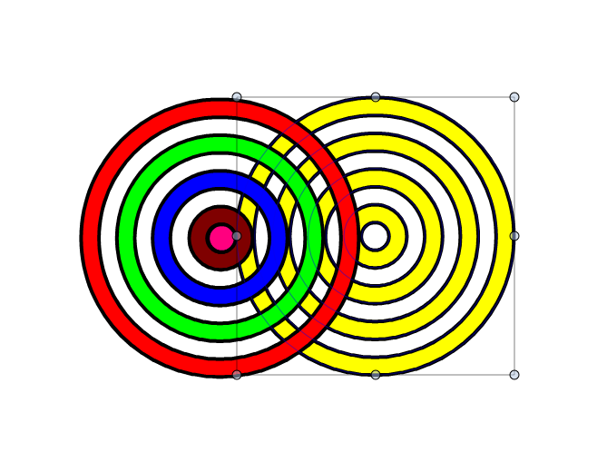

  • @VectorStyler Thanks for the reply, though I'm not sure I have made myself clear.
    When bucket filling just one yellow ring with a different colour, this ring becomes a separate item, which you can drag off and the item you 'filled' remains unchanged.
    In the attached picture, the yellow circles are one item
    0_1726416582341_Untitled.png .
    I coloured each yellow circle in the colours you see.
    I was then able to move the yellow circles away from coloured circles, which are all separate items.
    I did not want this, I wanted a single item with different colour circles

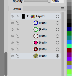

    As you can see in the layers, all the circles I coloured have become separate items.
  • @GRH I have just seen the tool tip appear. The bucket fill creates a new shape.
    This is not what bucket fill should do, it should fill the existing shape with the desired colour, not create a new shape with the chosen colour.
    @GRH said in Strange (though useful) behaviour; is it a bug?:
    Now I got it, yes, this is the intended behavior, to create a new shape. This can be changed by enabling the "Remove Shapes" option in the context panel. If enabled, then the filled parts are removed from the original.
