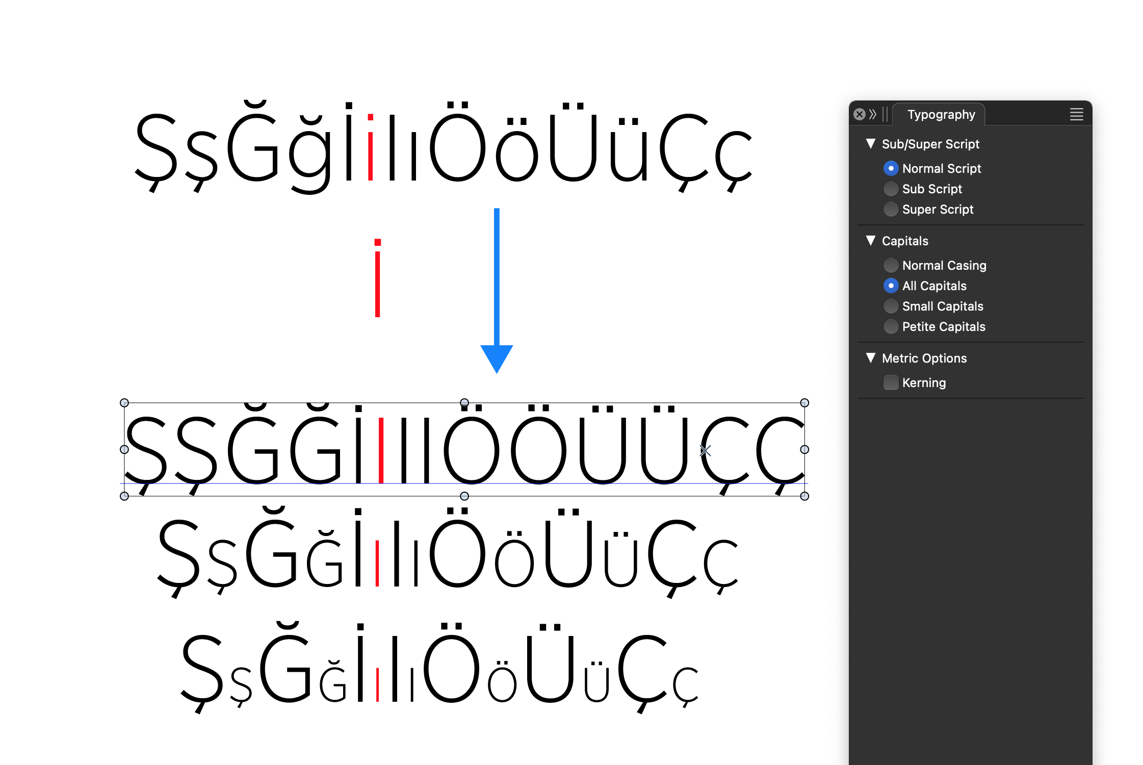

In Turkish, the lowercase letter "i" should be replaced with the uppercase letter "İ". It is not replaced with the uppercase letter "I".
@hbalcic I will open a bug on this. What language is selected in the Character Style -> Typography -> Language drop down (right side) ?
Character Style -> Typography -> Language drop-down menu (right side) "Turkish" language is selected.
The Styling/Small Capitals option below also did not work.

@hbalcic There are two errors in this menu. (again in Turkish)
@hbalcic Replicated. Is the right column what it supposed to be?
This is how the right two columns should be.
Change is like this.
(Glyph name)
i > İ > i
i > (Idotaccent) > iı > I > ı
(dotlessi) > I > (dotlessi)
