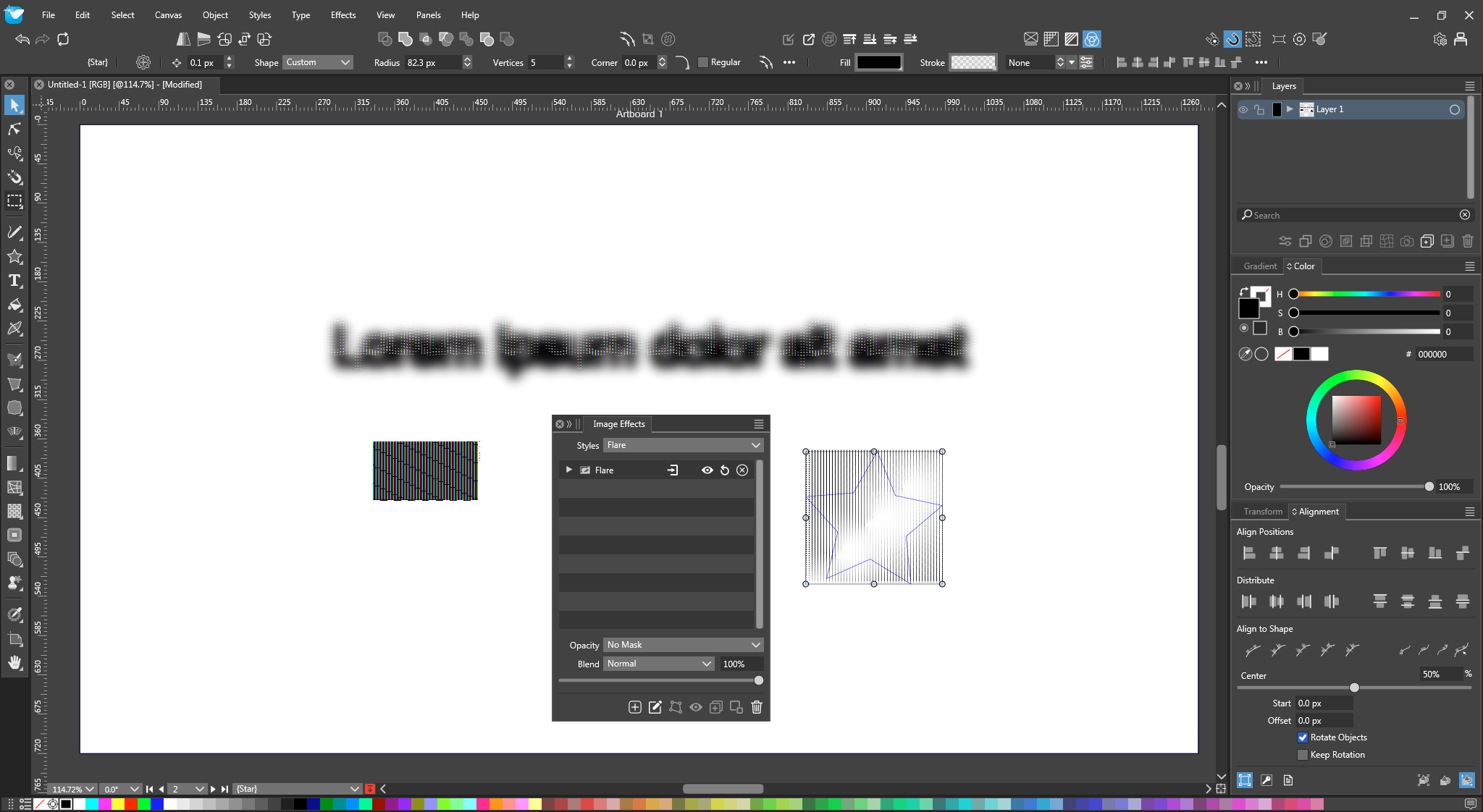

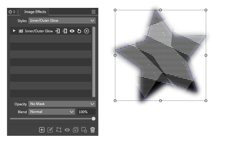

Problem: If I use NVIDIA CUDA as the renderer and appply Image Effects, things look really weird.
Rather surprisingly to me, software rendering is actually the least problematic and fastest.
Tried updating NVIDIA driver to 555.99 (below image), and it still looks weird.

@VectorStyler OpenCL works fine, but after applying effects, said effects don't show up until a bit later (feels like about 0.6 to 1 seconds). Not bad, but software rendering is faster. Tested with applying box blur, wave noise, generate noise and outer glow on a simple solid-fill rectangle.
Software rendering takes about 0.5 seconds or less for each of the same effects.
