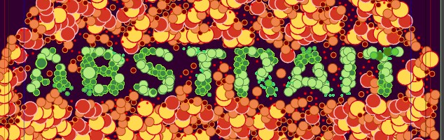

@VectorStyler There are two sets of symbols visible in the symbol panel. I've sent you the file before placing the second set on the artboard.
What I've tested is a way to get this kind of graphics editable in all aspects in order to avoid to redo everything if the design had to change. To get this, I have two independent separate containers to apply the Repeater feature.
I thought that by doing a BO (minus) with an object or text, I could manage to maintain the text live and editable to see in real time any effect in the arrangement of repeated objects.

@VectorStyler thanks, but it's not quite there yet: the containers are not mutually exclusive, so the objects overlap
@Pat said in Editable text after a Boolean operation:
The type of repeater combination, as shown in the earlier image is not achievable now. The two repeaters arrange objects independently, and if not clipped, the symbols may overlap.
