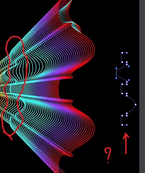

Some curious things can be observed after blending. Suddenly, the shape of an object appears shifted (no stroke), and it's possible to change its shape, which has a consequent effect on the overall design??

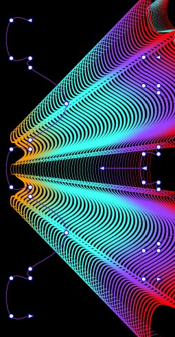

OK:
Not OK
@Pat I will try to replicate this with the existing file, In the second image, there is a horizontal line segment pointing leftwards. This is a blend spine, somehow it gets added (could be because of the flipping).
I will try to fix this.

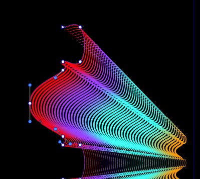

@VectorStyler I've just tried a simple rotation and same "issue":
@Pat Try the Blend panel menu Remove Path after the rotation, does that fix the issue?
@VectorStyler Yes, it does but the overall shape of the object changed.
