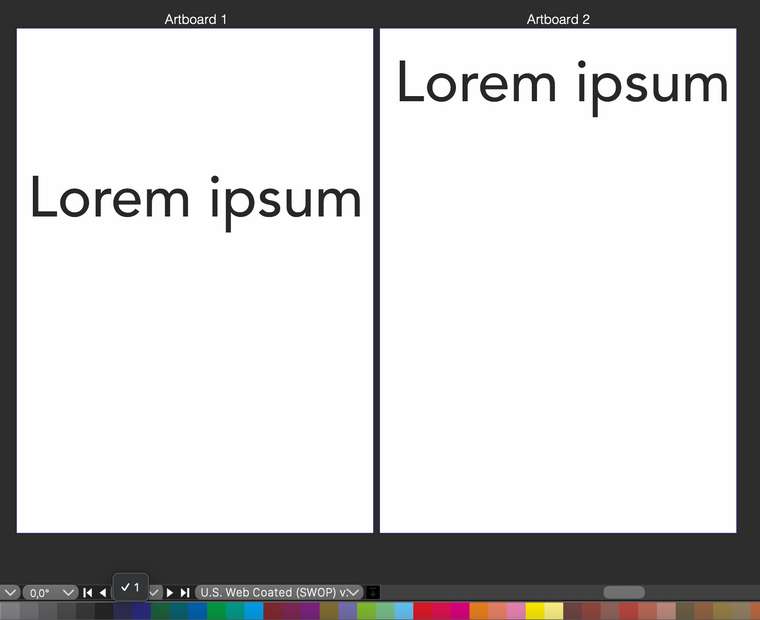

Artboard list is not updated
When an artboard is added, I assume that the list on the bottom row should be updated to show the number of artboards that exist in the document so that it is possible to navigate between the artboards using the list and related arrow buttons. Now the list is not updated so there is always just number 1 in the list.
Additionally when a new artboard is added, I think it could automatically be placed beside an existing artboard. Not it is placed at the same position as an existing artboard (0,0 coordinates) and can be repositioned only by rearranging the artboards via a menu command. I wonder if there is also a way of positioning the artboards by using the mouse?
@Arde When using the Canvas -> Create Artboard command, the new artboard should end up at an empty location (right of the current artboard). If not, it is a bug.
I can replicate the numbering update bug, this will be fixed in the next build.

@Arde This is fixed in the new build (1.0.022).
