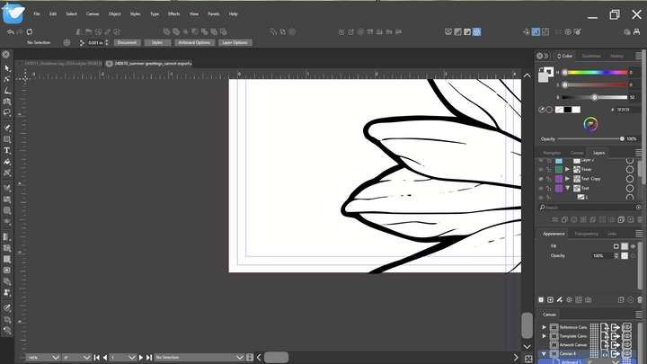

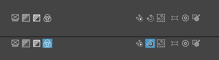

                  • debraspicherD Offline
                    debraspicher
                    I have the opposite problem. My interface elements have doubled. 😆
                    Fun fact: The toggle UI feedback only works on some of the UI elements when this happens.
                    I linked a video and if you notice it loads in the center of the screen and then that splash screen scales down UI wise. So it may be "redoing" the layout without cleaning up and thus creating duplicates. Maybe? Loading the "Default" workspace still ends up with doubles.
                    Video of behavior:
                    https://1drv.ms/v/s!AuWHX0h5bAoRifU9f2cCi_uxRcEijA?e=yzAUzQ
                    Workspace files:
                    0_1712973896996_workspace-files.zip
                    I deleted the contents of the folder with VS closed and reopened. Seems fine now.

                      VectorStyler @debraspicher
                      @debraspicher I try to find out what caused this. Was there a workspace loading / resetting when the docked panels doubled?
                        debraspicher @VectorStyler
                        @VectorStyler I wish I could be of more help. They opened with the program panels doubled. If you have any suggestions how to debug or where to begin monitoring, then I could keep an eye on it for when it happens again.
                        32GB RAM @ 6000MHz
                                    debraspicher
                                    I haven't figured out a trigger for this, but I've been trying. Occasionally I will go back to VS and the UI will be in this state.
                                    Video link below... (LOUD music warning: I'm sorry in advance for the music, I forgot my headphones were toggled in OBS):
                                    https://1drv.ms/v/s!AuWHX0h5bAoRifY14BXgOVp8BGU-Pg?e=T61kp9
                                    Restoring using View>Workspaces>"Default Workspace" gets us back in business, so it's not like the defect from before where I had to clean out the WS folder. But perhaps that was a result of me closing the program after the issue occurs? (I'll try again later...)
                                    This has happened twice so far and these UI issues always occur when I go back into VS after a break while it was running in the background. I lock my PC at night so my monitors will shut off and leave it running overnight, so maybe something awful occurs when my displays wake back up. Perhaps if I stop leaving it up when my displays go idle it will stop occurring?...
                                    32GB RAM @ 6000MHz
                                      debraspicher
                                      I can confirm when VS is closed with a "corrupt" interface without reloading the Default, it apparently saves itself as the new default. I followed @Pat's solution and had a WS saved in case which I used to get back the original state. Video: https://1drv.ms/v/s!AuWHX0h5bAoRifY4lt8pfV_Rsi3QjQ?e=WFdylB
                                      Once again, this issue appeared again when I left the PC on idle (monitors off).
                                      32GB RAM @ 6000MHz
                                        @debraspicher said in Issue with the interface:
                                        Can you save a workspace when VS is in this broken state, and send me the workspace file? I would like to replicate this.
                                        Also: the detached context panel is not really a bug (it can be detached by dragging).
                                        But the document tap showing at the bottom is a bug.
