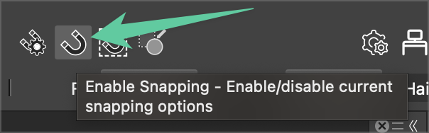

By chance do you have the snapping enabled? In the upper right corner of the screen
No, the snapping isn't it.
