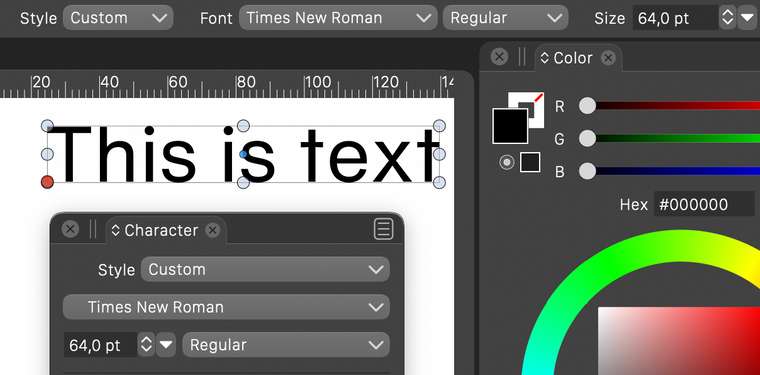

There seems to be a bug related to shape text frame:
This happens if the font of a shape text is subsequently changed. The font is shown correctly whenever the text is in editing mode but as soon as editing mode is finished and the text shape remains selected, the original font that was used when creating the text shape, will be shown instead.
This error does not happen with paragraph text frames.

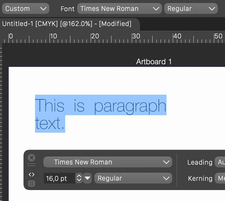

This is fixed, thanks, but there is still a bit similar error when using paragraph text frame: clicking four times within a paragraph text so that all text gets selected shows the initial font of the text frame, even if text editing and selecting the text frame with the selection tool shows the correct font:
@Arde This issue should be fixed in build 1.0.048
