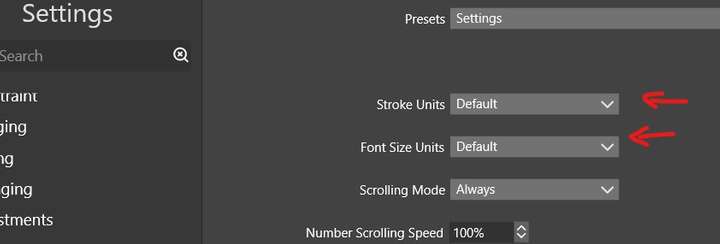

In settings I've changed the unit for the stroke & the font but I have to reset them each time I launch VS. Can't I store these parameters?
@Pat I tried replicating here, but these are stored persistently. Not sure what could cause this issue.

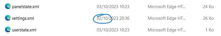

@Pat Is the settings.xml file time changed after exiting VS? There were a few cases where it could not write to that file.
@VectorStyler It seems that this file is unchanged :
@Pat That is the problem. Somehow VS cannot write to that file (access rights maybe).
