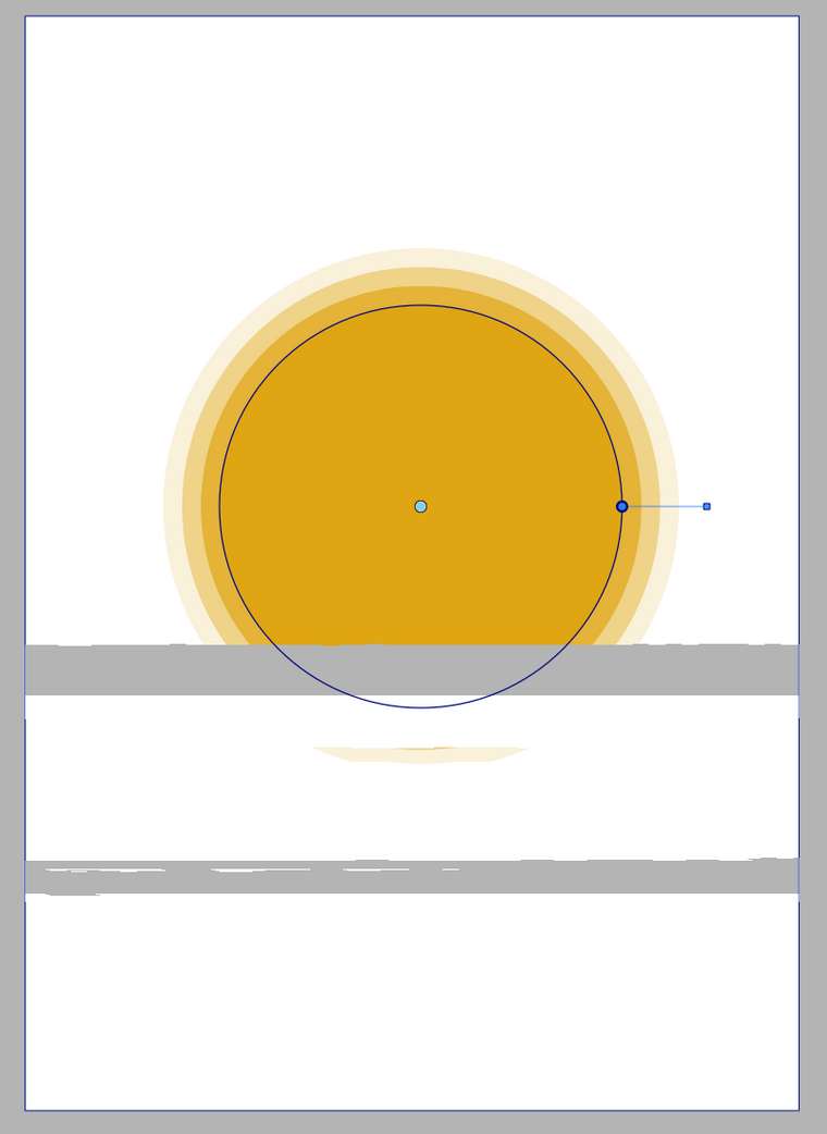

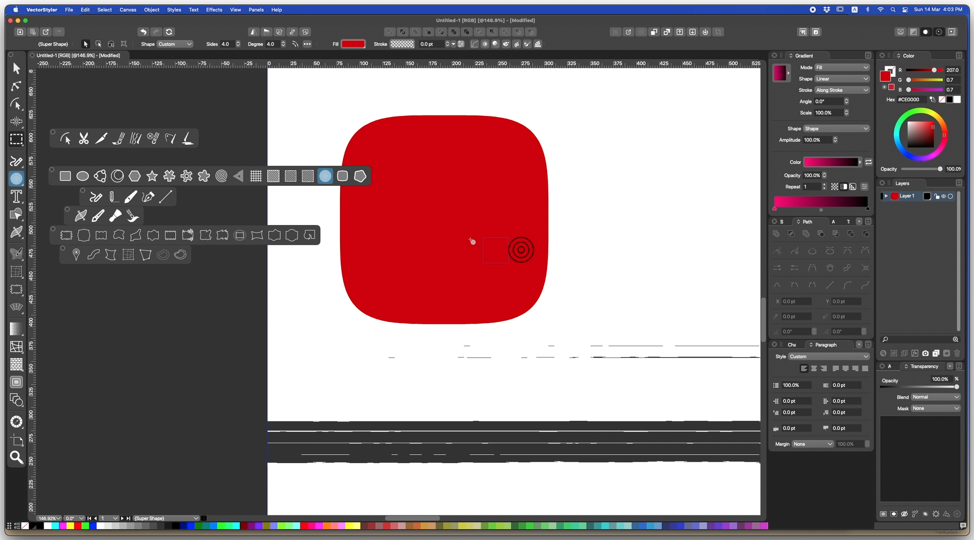

As visible in the screenshot, the canvas will often flicker with these dark glitches which, i can assure you, are not part of the design as cool as they look, it happens randomly and often when moving or drawing shapes.
Here's a recording of it https://www.youtube.com/watch?v=6uvpEuVqLow
Not sure if related but as you can see the Blend and Transparency functions will also sometimes stop working when the glitching occurs.
