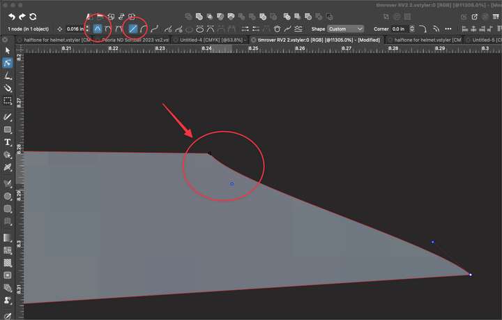

        I was continuing work on this project and it kept happening - especially with nodes you glance at and want to be sure are converted like this one:
        0_1687451298501_3e294aa3-370c-4fc6-a644-a8cb1d31eace-BLD 2023-06-22 at 12.27.26.png

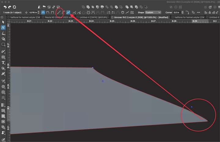

        At quick glance, unless I'm checking the contextual menu, I don't know if this is already a cusp (I could alter the node symbol to help with this) but pressing the double tap L only converts my cursor from the node editing tool to the path sketch... grabbing the node on the far right end and pressing "1" to change the segment to a line segment was the real answer.
