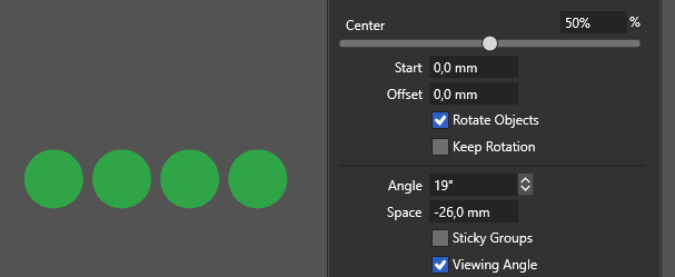

                  @VectorStyler I wonder if it would not be better for negative values to reduce the space between objects. Currently, the opposite is true.0_1687538664974_screenshot_20230623_184210.png
                  Windows 11 Home 10.0.22621
                    VectorStyler @encart
                    @encart Depends on the order of the selection and the alignment direction.

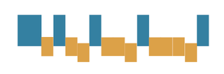

                                  @Igull
                                  is even possible to do some Math here
