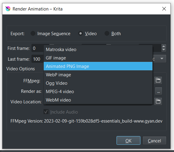

                    @b77 Maybe a bit late, but Krita is quite capable in animation. It has an APNG option in rendering animation:
                      b77 @Harry
                      @Harry Thank you. I imported some PNGs on separate layers, but the 'Render Animation' command is greyed out.
                      • H Online
                        Harry
                        @b77 When you first open Krita, you have to save file as krita document (.kra extension) to enable Render Animation option. Then you have to install ffmpeg to Krita.
                        This is a great tutorial how to do it:
                        https://www.youtube.com/watch?v=-B3LDBlkFWU
                          b77 @Harry
                          @Harry Thanks! I found Mac builds on this website, installed FFMpeg and APNG export is working now.
                          But… I have no control over ppi and looping… I'll try again tonight to make sure I didn't miss some setting.
                          Thanks again. 👍
