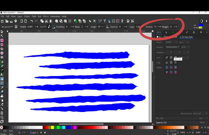

      In my opinion, the main vector apps' weakness is their brush strokes.
      Since they are stretched, they all look the same - especially when they're the same length. That does't look natural:
      There are "Tremor" and "Wiggle" parameters in Inkscape's "Calligraphic or brush strokes" which provides more natural stroke feel:
      Is it possible in VS to draw lines, which are randomized "live"?
      This way they'll look more like "painter's brush" and every stroke would be different.

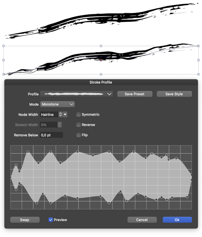

        b77 @Harry
        @Harry Interesting. Can you explain a bit what the 'Tremor' and 'Wiggle' options do exactly?
        In any case, disabling the symmetry of the stroke profile and making it as irregular as you can results in similar brush strokes:
        (The first stroke i. the screenshot above has a default profile)
          While I find the idea interesting. Tremor and Wiggle change the parameters of a brush
          a bit but basically the brush stroke itself remains the same.

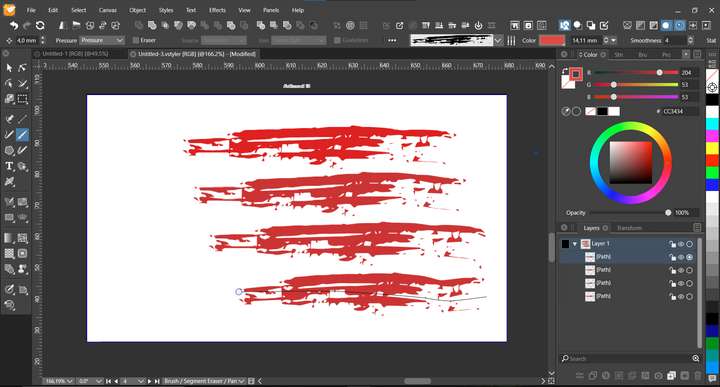

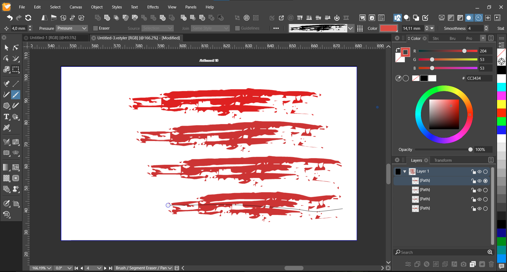

              VectorStyler @Harry
              @Harry This is already doable with some work, by creating a new brush shape.
              But it requires more steps, and a new brush content.
              I added this to the backlog.
              In the attached file adjust the random "Seed" parameter of the shape effect on the top-right object (Effects->Edit Shape Effects)
              0_1670309365492_randombrush1.vstyler

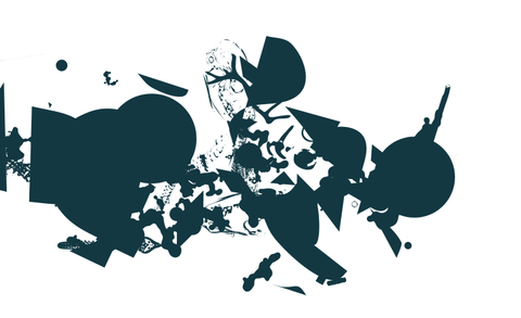

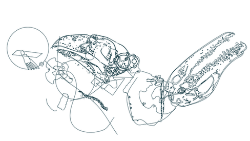

                ... Are the brushes in Alchemy completely random brush contours? ...
                Alchemy uses random shapes, but you can create them yourself
                and save them in a PDF File and put them in a special Alchemy Folder.
                And when you draw with the pull brush, Alchemy takes these shapes
                randomly from the PDF file and puts them on the canvas.
                It has also some more random generators
                The results can be saved as .SVG or .PDF for further editing in VS
                  Subpath @VectorStyler
                  Looks good.
                  Can you tell me what shape effect you used for this ?
                    VectorStyler @Subpath
                    @Subpath The "Outlines -> Detail" shape effect, with "Randomized" option enabled.
                    If you select the original brush shape on the top left of the artboard, you can see the effect options in the Effects->Edit Shape Effects
                      @VectorStyler , thank you

                        According to Inkscape's tutorial Tremor produces anything from slight unevenness to blotches and splotches. Wiggle is the resistance of the paper to the movement of the pen.
                        So yes, as @Subpath mentioned this is not the best example here.

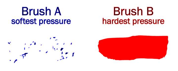

                        Since we are painters or draftsmen, our tools are stylus and mouse. Let's take 2 different brushes from our presets and styles - Brush A for softest stylus pressure (or minimum mouse velocity) and brush B for hardest stylus pressure (or maximum mouse velocity):
                        Everything in between those 2 brushes is a result of "modulator" which changes brush appearance live. "Modulator" should be stylus pressure or mouse velocity dependent.
                        Modulator can be for example:
                        • blend tool
                        • shape effects
                        • interpolation
                        • randomization
                        • variation
                        • @VectorStyler 's imagination, etc.
                        General purpose should be that effects are aplied live and every stroke is different, even Brush A and Brush B should have little "initial" blending, randomization , roughness etc. to make them different.
                        Is it possible? Any other ideas?

                          VectorStyler @Harry
                          @Harry said in Brush "live" randomization / variation:
                          This does not exist in the current version of VS.
                          Technically, it could be possible to implement, but some things must be clarified:
                          1. From what I see, the "modulation" would vary along the path, based on pressure or some other input.
                            This cannot be done with current shape effects.
                          2. Also: we have to keep in mind that these brushes are vectors, so would this mean that in case A (soft pressure), the vectors would break into some form of random smaller shapes?
                            VectorStyler @Harry
                            @Harry I think this "modulation" along the brush path of some distortion parameter is an interesting idea.
                            I added this to the backlog. Some details need to be worked out (ideas are welcome), but I think this could be implemented before version 2 (if not version 1.2).
