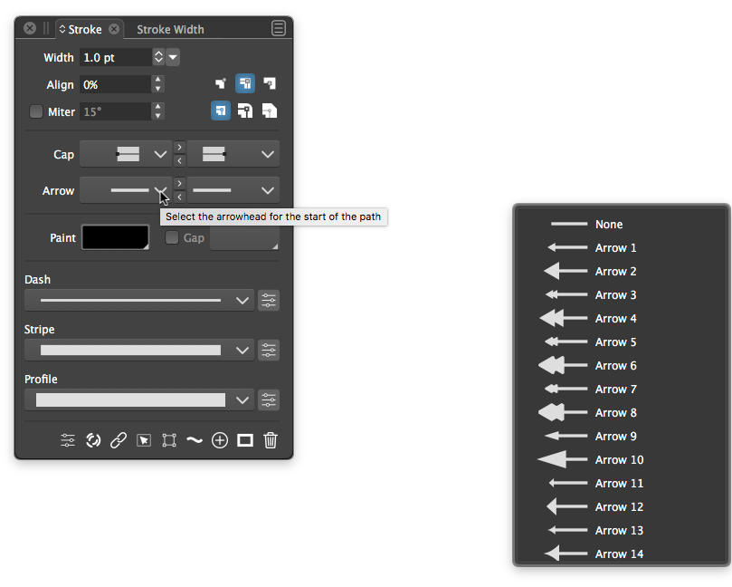

I have moved most of VS's floating panels onto a second monitor, which is to the left of the main monitor, to reduce clutter in the document window.
In the panels, all of the popup menus that have non-text content, eg the arrowhead popup, appear horizontally displaced away from the panel. Always butted to the right edge of the second monitor, as shown below.
The same issue affects the Dash, Stripe and Profile popups in this panel, but not the Cap popups.
The same affects similar popup graphical menus in other panels, and in modals.
All work correctly if moved back to the main monitor.This is on a MacPro5,1, Radeon HD 5770, 2 x 2560 x 1600 px, OSX 10.12.6.
Any suggestions?
@Raven Welcome to VectorStyler.
So this might be a bug when using two monitors.
I will try to replicate this and have a fix as soon as possible.
@Raven Can be replicated on dual screen setup!
@Raven This issue should be fixed in build 1.1.072
