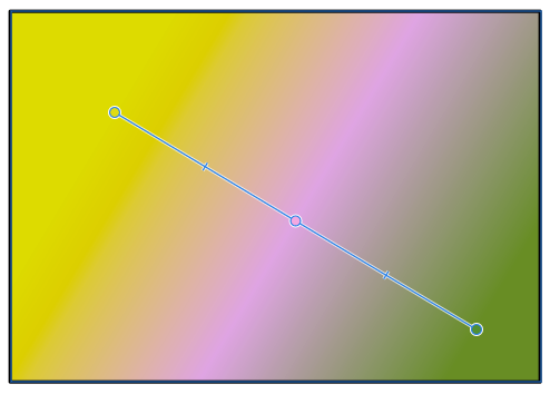

- Too many controls. Personally I am initially confused by both a size and a gradient editor - the two parallel lines. It also takes up too much space. I could easily adjust the length and position moving the start- and end point that could work as start and end points, see how simple it looks - and smaller - in Aff. Designer:

Point 1 is problematic. The reason for these extra controls is that these are different parameters of the gradient. One scenario that cannot be correctly edited with a single axis is when the colors are repeated (see gradient panel), and they do not start or end at the ending points.
But I can do an option to have a simplified gradient editor variant.
Also: if the gradient has multiple shapes (a complicated scenario), a third axis will show up to position these shapes.Point 2: controls will can be made smaller.
Point 3: the gradient shape changes can be restored to linear (or other basic form) in the gradient panel, by selecting an other shape (inclucing Linear) in the Shape field
