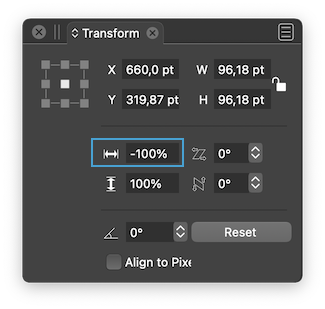

 @PatrickM It looks like one of the two circles is flipped horizontally. Check this value here in the Transform panel and if it has a minus, delete it:

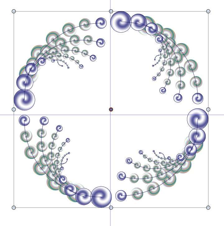

 @PatrickM Could be that they were scaled or rotated? What is the node editor showing when the start / end is selected? Send me the file with that blend, I will try to figure out what could cause this.
 @b77 said in Transform/rotate after blending, weird behaviour or crashes VS: It looks like one of the two circles is flipped horizontally. like @b77 wrote, it looks here like @PatrickM Result
 if a Circle was horizontally flipped in my Test
 the Circle on the right side.rotate a circle looks different
 @VectorStyler It seems to have been a temporary issue just after the installation of v.065. @b77 & @Subpath It was indeed that unintended mirroring problem. I haven't managed to reproduce it yet and everything is as expected now. @Boldline This is what I usually do and will do if I reproduce the problem. Thanks to all!

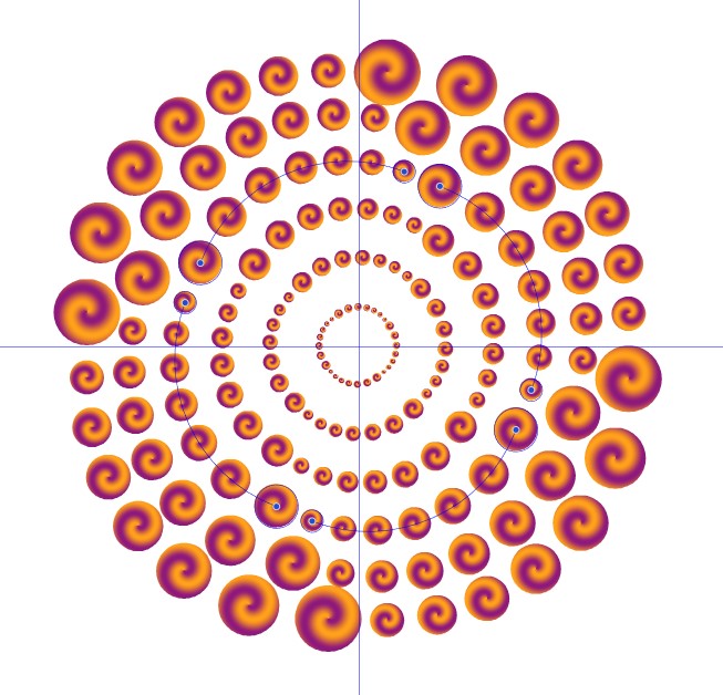

 @VectorStyler It is much better with v.065 ; no crash so far and expected pattern design.
 Well, it is only a quick test and it is virtually nothing of interest as pattern but to show you that we can start to get patterns:- with "copy",
  - with "clone" however, I've got an  interesting pattern but totally unexpected with respect to colours; I've just changed one colour (blue) of the gradient & I've got this multicoloured design

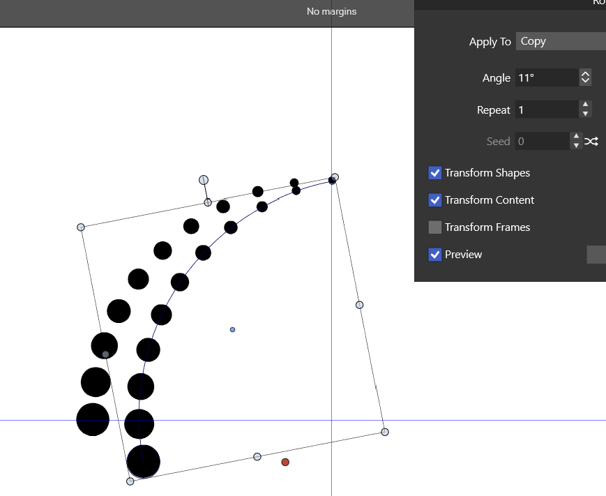

 @VectorStyler There are still some issues with the "clone" feature of blended objects (0.075 ; W10 & W11).
 @Pat said in Transform/rotate after blending, weird behaviour or crashes VS: @VectorStyler There are still some issues with the "clone" feature of blended objects (0.075 ; W10 & W11). @Pat email me an example where this occurs
 @VectorStyler You can test on all the files I sent you including the one from last week. Just use the Object-Transform-Transform/Rotate feature(s) with 'clone' and you will finally get the issues. Just compare with 'Copy' where all the object changes are done correctly. Thanks.
