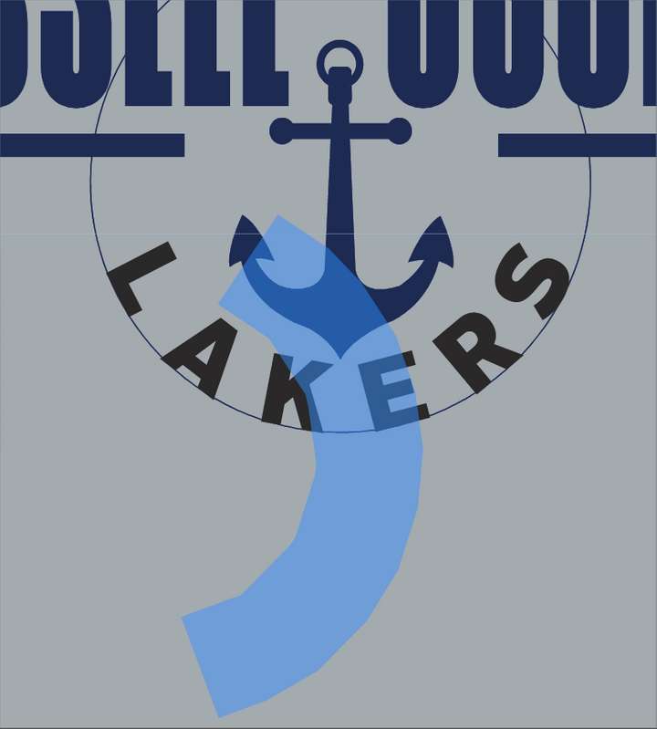

Text on a path seems to have issues when you flip to opposite side
I am running into issues trying to adjust the letter spacing and alignment of my text "Lakers" after I've flipped it to the inside of the circle path. When I try to double click to highlight it, it seems to highlight an odd area instead

@Boldline Can confirm the issue here. I also released the text from the path then placed it again but it doesn't fix it.
@Boldline I added this to the backlog. Will be fixed ASAP.
@Boldline There seems to be a transform on the text that causes this issue. Since text on path cannot handle extra transforms on the same text, just remove this transform (Effects -> Remove All Shape Effects), and the editing will return to normal.
I will fix this bug ASAP.
@Boldline This issue should be fixed in build 1.1.072
