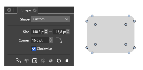

    it depends on the State of the Corner nodes
    if all Nodes are in blue, changing a value work for all Nodes

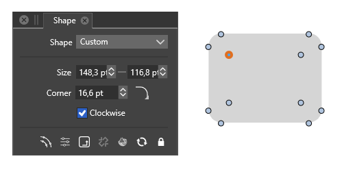

    if one or more Nodes (you could select it with Shift key)
    in orange then changing the Value work only for this Nodes
    this work in Shape Panel and in Contex Toolbar

  • @Subpath said in Problems around the corner:
    Not here they don't 🙂
    Normally I would use the shape editor to select the specific node, but it seems you have to use the transform tool - that selects the whole object, then you can select the specific corner (in orange like yours) and apply a value, but it still applies that to all the corners 😞
