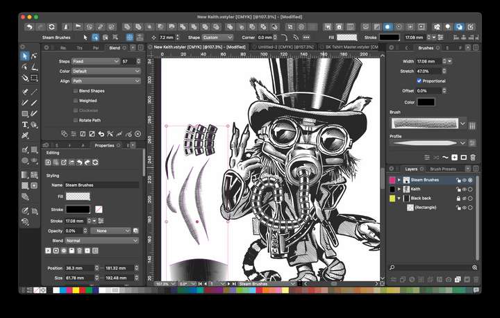

  • The Steam Kittens have requested a back print for the T-shirt featuring Keith (the steampunk kitten character featured on the front) so thought I'd have a crack using the method detailed in this post and glad to report it was far less bother to do the shading using the brushes I made and really easy to edit ---- did have a fair few times that I had to force quit when doing the top hat detail, but got there in the end --- Still need to add tour dates and a logo:

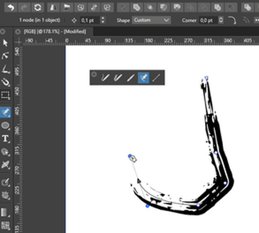

    There are actually two concepts here.
    The first one
    -- How to draw a vector brush with the Pen tool.
    You can't do this directly and just go for it.
    You have to draw a line with the Pen Tool.
    Then select the your Brush and set then
    the brush thickness.
    Another way i found is the following:
    Select "B" for the Brush tool.
    Paint a short first piece of your path with the Brush tool.
    (this short piece should stay selected)
    Then switch to "P" for the Pen tool and now you can continue
    and draw your vector brush with the Pen tool.
    Here a Video Example for this case:

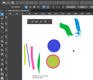

    Here the Second one
    -- Suppose you have four different strokes in your design.
    (different size and color)
    and you know that you will use them very often
    You could create styles or presets for them
    and select them when you need one of them
    -- or you could try it this way
    Create your four strokes in the style you're going to need
    and put all four strokes next to the canvas
    For simplicity, I'm only using the Pencil Tool
    (but this method also works with the Brush Tool)
    (but the Brush Tool normally doesn't take any color information,
    Pencil Tool do)
    Now press "P" for the Pencil Tool
    move the mouse pointer over the area where your strokes are located
    hold the command key (Mac) / CTRL key (PC) and select
    one of the four strokes you want to draw with
    As you may know VS draws always in the style of the last selected
    object/stroke
    Therefore, when you draw, you draw now with that style.
    I think this is an easy way to quickly switch between
    different strokes
    Here is an example video (with recorded shortcuts):

    Great way of starting off a job! --- I'd like to steal that for my workflow, if you don't mind ----- I've already set up the main brushes on the page I use for all the Steam Kittens illustrations I'll just copy paste my set brushstrokes into the next job artboard and away we go 👍 👍 👍 0_1658305858088_Screen Grab 2022-07-20 at 9.29.43 am.png
