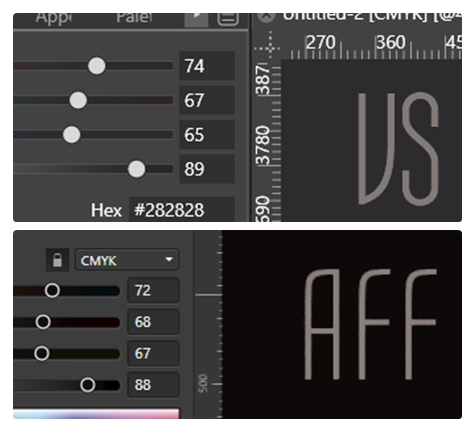

Black in CMYK profile is not black

@plrang What was the CMYK color profile used in Affinity and in VS?
@VectorStyler CMYK/8 Web Coated v2 both.
@plrang I think VS needs a "Rich Black" option.
@VectorStyler This is how I see it.
@plrang I will try to replicate this with the color profile. What is the Display (RGB) profile used in Affinity and VS?
@VectorStyler Both use the same sRGB ...966 2.1

It is extremely important that the software (can) only displays rich black but not automatically output it!In a normal prepress workflow you'll want to see when (and where) a normal black has been used especially when mixed with other rich black elements. There are tons of reasons why a pure black element must stay pure black in output.
So if you're going to implement this, make sure that display and output of rich blacks are optionals.
Thanks!
@Torakikiii said in Black in CMYK profile is not black:
Will do so.
