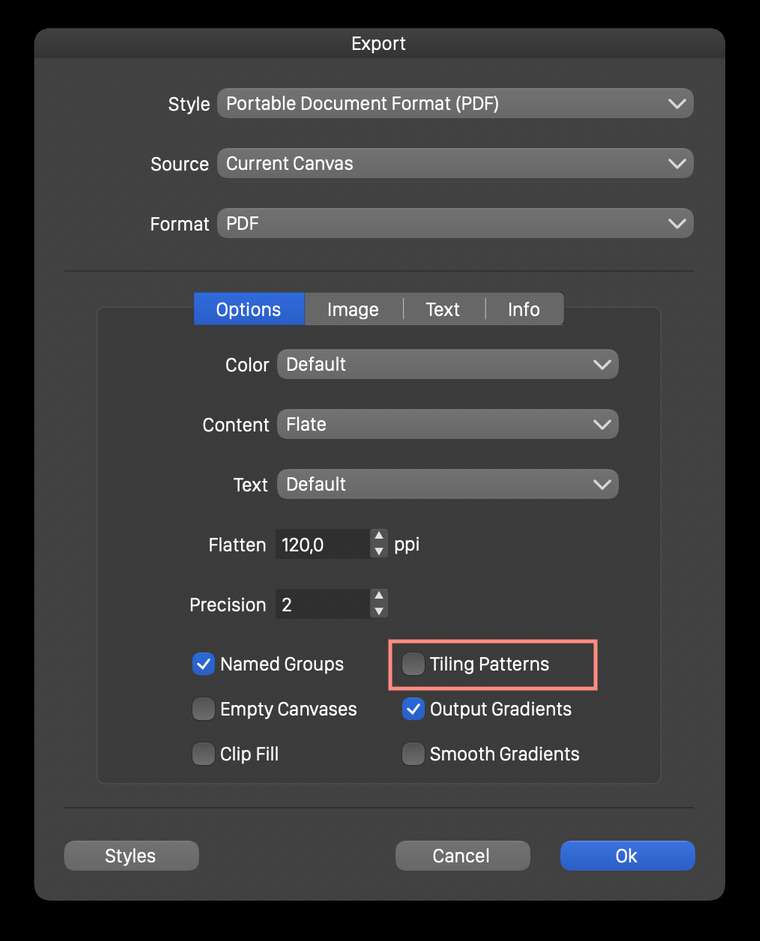

  • I run into the problem that the patterns I create and use are not being exported to the PDF. They are simply not there. This is a problem if I would want to send my work to someone or have it printed. Everything else seems to work OK, except that I cannot set a color profile for the PDF from the export settings. Also advanced settings like bleed are still missing.
    For a workaround: uncheck "Tiling Patterns" in the export options:
    Seems to be a bug, in converting the pattern to PDF patterns.
    I add this to the backlog as a bug.
    There have been improvements on the tiling pattern export to PDF.
    Let me know if it works for you also.
  • It seems to work better now, I can create a pattern preset and apply it to a shape and export this correctly to PDF. This now also works with the built-in patterns. Great work, thanks for this!
