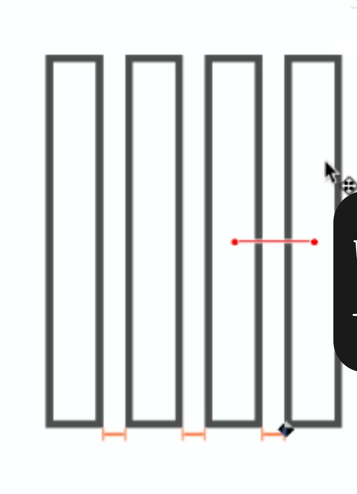

 https://imgur.com/8JiWO5P
 Inkscape alpha 1.2 align and distribution upcoming. Will love to see featue like that in VS
 @Jayanta-Das Is this a snapping mode when moving objects?
 @vectoradmin yes.
 @Jayanta-Das Then in VS: View -> Guides -> Snap to Distances
 @vectoradmin I will look into that. Thanks

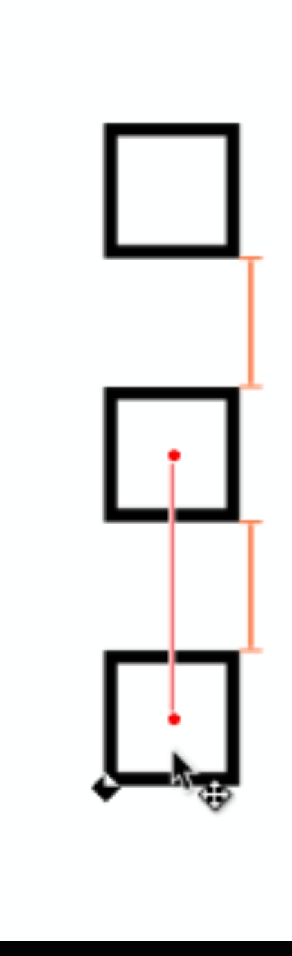

 @vectoradmin https://recordit.co/Kwf5SzqukE
 Is this a bug?
 @Jayanta-Das In the Snapping panel menu: is the "Snap to Original" disabled?
 @vectoradmin Yes it is disabled.
 @Jayanta-Das Try enabling that option. At least the example in the recording is affected by that.
 @vectoradmin Thank you. It works now.
