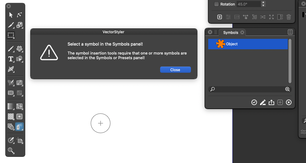

Symbol selection highlight not clearing after deleting object used to create symbol
There is an occasion when a symbol looks like it is selected but it's not. (see screenshot).
The easiest way to see this is:
- draw an object
- add it to the symbols panel
- delete the object from step 1
- the symbol is still showing as selected in the symbols panel
- select the symbol spray brush (for example)
- tap canvas and then warning occurs
The quick way around this is to deselect then reselect (again) the symbol in the symbols panel.
@Jono I added this issue to the backlog as a bug.
@Jono This problem should be fixed in build 1.1.008
