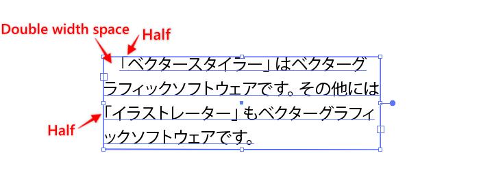

@vectoradmin
Also opening brackets(quotes) always have to be half width when they're at the start of the line.
([{〈《「『【〔〖〘〚〝Paragraphs usually starting from a space(Japanese space which is double width) and if a opening bracket follows the space, it has to be half width.
(actually opening brackets(quotes) following a space have to be half width regardless of its position.)
