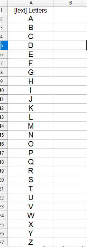

I have single-column text data:
I'm converting it to csv file using Unicode (UTF-8) character set and OpenCalc. I found it is best for csv export - it fixes regional comma problems with Excel and Google Spreadsheets.
When there is only one column in the csv file, VS freezes while importing it by "Data Sources" panel. After adding the second column of the text data, the file imports properly.
