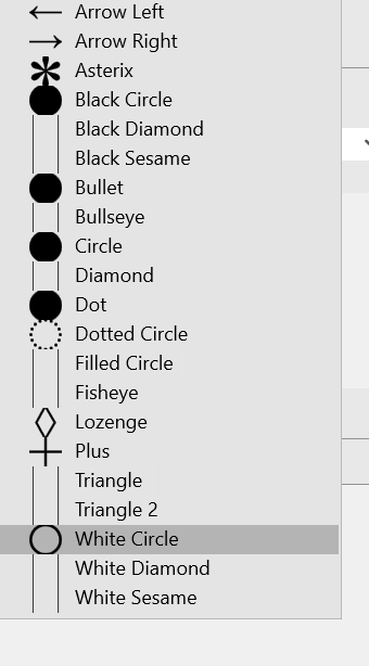

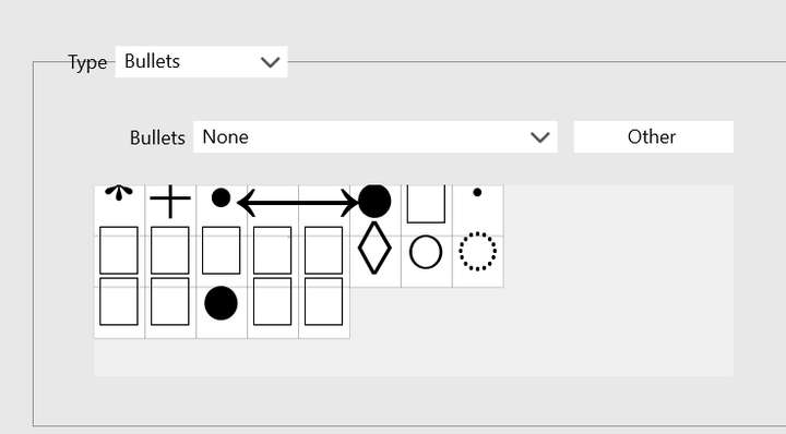

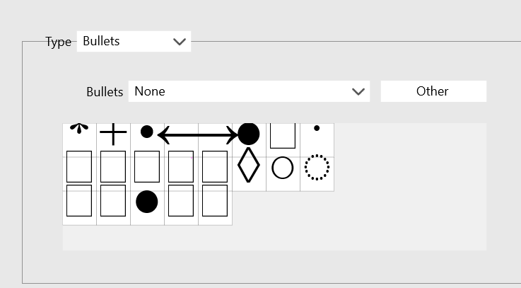

    3. Paragraph Options > Labelling > Label > Bullets interface is not displaying all the default Bullet glyphs correctly:
