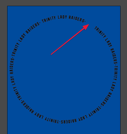

is there an option available inside VS, to auto-resize text to fit properly within a limited size space? For example text around a circle path, the spacing is limited. could we highlight the text and press a button to "fit to space" and it would auto correct the font size so that all text fits?
Maybe as an option in the "Text on a path" panel?
This would be applicable to any path - it would use the path the text is being placed onto as the overall length to fit the copied text into, or if you type directly on the path it auto-adjusts sizing to make it fit

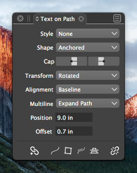

@B77 helped me find the answer; "Choose 'Distributed' from the Multi-line dropdown menu in the Text on Path panel."
@Boldline In the Multiline drop down, select Distributed
