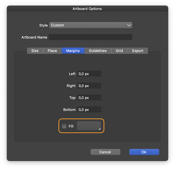

  • @Boldline Option-Ctrl-A should display the Artboard Options, and under the Margins tab you can enable artboard fill:
  • @b77 Thank you for sharing that - not sure how I missed it but that is really helpful
