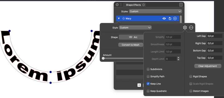

Bendy Arc warp
I agree with boldline, looking at your original template
it seems to have been created with text in path (curve/circle)
And not with the arc warp tool.If you did it with text to path, you would even have more options
to adjust the spacing between the letters.

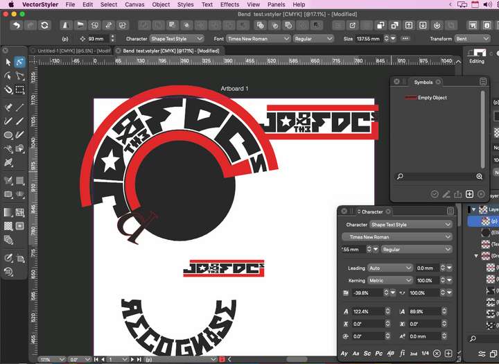

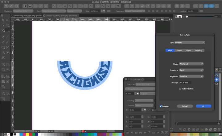

And not with the arc warp tool.I definitely originally used the arc tool in Illustrator as that was the method I always used - but just had a mess around with text on a path in VS and using Bent transform - works great - cheer's guys

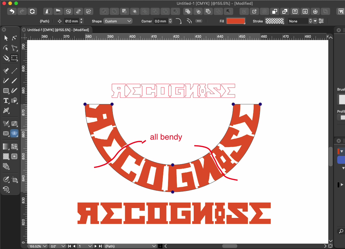

If you select the curve and object(s) and then select the rightmost
tool in the Align to Shape row. The "Adjust Object Position Manually tool....."Then you can manually reposition objects on the path/curve
and objects will still follow the path.Here is an attempt of mine.
These are Objects (Text in Curve converted)

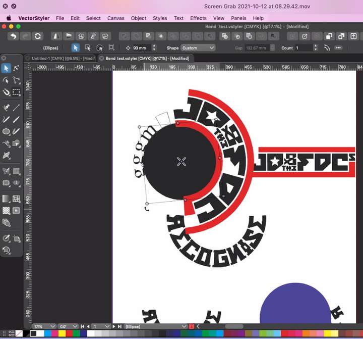

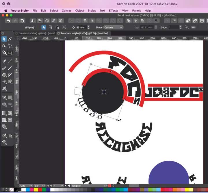

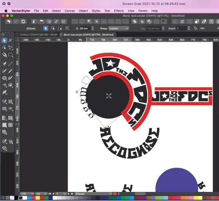

Just experimenting with the text on a path tool and pleased to report that it works with logos pasted inline, although, there seems to be a display bug - it is a shame you can't get the same distortion accuracy with the arc tool, but at least the effect is still achievable within VS - I did try to upload a screen grab vid to illustrate the bug but don't have privileges, so have just got a few grabs from the vid
@Dazmondo were you uploading the video directly to the forum, or a link to a video? The forum does not yet allow files to be uploaded for some reason. Did you try linking a video instead? That does work.n
No didn't try the link - I'll remember for next time - thanks Boldline
Pleased to report that you can even drag a symbol inline and it updates to changes to original ------ ACE------
