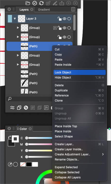

  • @b77 @vectoradmin I was thinking about this today as I worked on a project that involves some clipping paths within it. I'm trying to edit
    0_1648242273806_5da65906-e539-4e22-a24d-f4fcd8473a2f-BLD 2022-03-25 at 16.55.51.png
    In this image below, I am trying to modify the nodes of the black fill with white stroke. VS keeps trying to select the vector I clipped inside the piece above but within the same layer. I naturally want to go into the layer panel and select this sublayer and tell it "lock all others" so I could just focus on the one part I was working with. I went ahead and locked the sublayer with the clipping path manually and that did the job. it would still be nice to be able to "lock all others" etc.
    0_1648339970950_86d015c6-322a-4a84-a15f-2160fd1256c7-BLD 2022-03-25 at 17.04.45.png
    In terms of if there are already things locked when you go in and want to lock more layers/sublayers. I would expect they stay locked until you manually unlock them or hit the "unlock all layers"
    @Boldline Added the "lock all others" action for the context menu to the backlog.
    When editing clipped shapes: if the clipping shape is hard to select, select the group first with the transform tool and then activate the Node tool.
    Typically clipping shapes of a group are not filled, so selecting them with the node tool can be a bit of a challenge, but if you hover over where their outline should be, the outline and the nodes become visible.

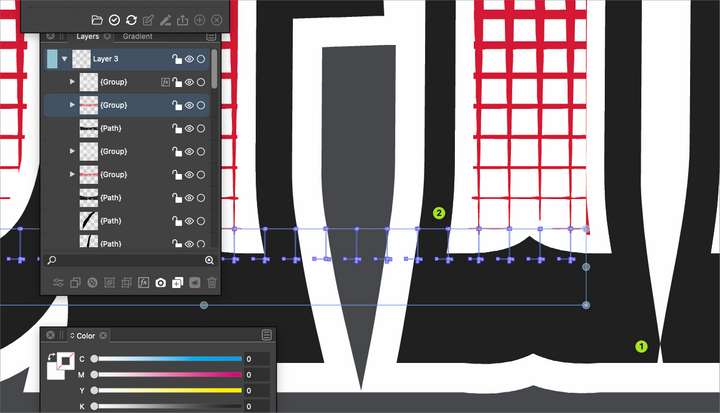

  • @vectoradmin For some reason the secondary image did not post in my most recent comment you replied to on here. I'll add it there retroactively to avoid confusion and here as well
    Right now with this situation, my issue is that sometimes the clipping vector wants to be selected when I am trying to grab things behind it all
    In the attached image, I was trying to modify the black fill and white stroke (1) but it kept thinking I wanted to select the white box pattern inside the item above (2)
