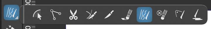

      Is the path simplifier tool the same as the path smooth tool in Illustrator? I tend to think they are different - that the VS Path Simplifier Tool reduces the number of nodes in a brushed over section of a stroke. Is there an equivalent to the Illustrator smooth tool that I'm overlooking? Basically a tool you use to brush over a stroke and it smooths out the stroke?

            @vectoradmin - I tried out the object>simplify path panel and I can see value in what you have put together. It will take me some time to figure out what settings give the best results. @861475_VctSt makes a good point about Illustrator's simplify path option; the focus there is to reduce nodes on a path that are unnecessary to maintain the current curvature of the path. If this already exists in your simplify path panel and I missed it - let me know. I think this could be an option added to the existing object>simplify path panel, like a partitioned segment below what you have now.
            The simplifier tool itself from the toolbar does not seem to be working as was mentioned before. But if I understand the tool correctly, this adjusts the sizing and graduation of the width itself - it does not reset the path trajectory, correct?

                    Here is an example of me using the Path Simplifier Tool as best I know how 🙂 in VS
                    I'm seeing very slight edits to the line smoothness. I'm focused at this point on literally smoothing out the direction of the path
                    Here is an example of what I am doing in Illustrator that I am hoping I can also accomplish inside VS
                    Each time I go over the edge of the shape - the part of the path I go over smooths out some based on how sensitive I make the settings in the dialog box.
                    This is a more "artistic" tool - in that it's not using the computer and VS to "compute" a level of smoothness for the whole path - but I can go in and tweak and modify sections of the path myself
                    Let me know if this helps explain what I'm saying better
