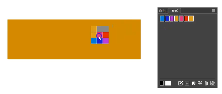

      The Selectet colors can be dropped via drag and drop
      onto a selected object with a Gradient.

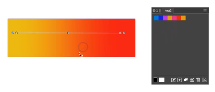

      Here the Steps for other Users:
      Create or select an object with a gradient.
      Select the colors in a color palette while holding
      down the Shift or Ctrl key (Windows).
      Drag the selected colors from the color palette onto the object
      with the gradient. The object's fill will change to
      a solid color.

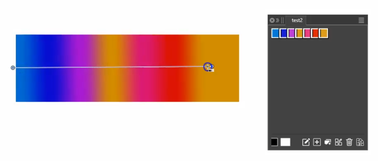

      Now, drag the gradient again with the Gradient Tool, and
      the gradient will now display the colors you selected.
