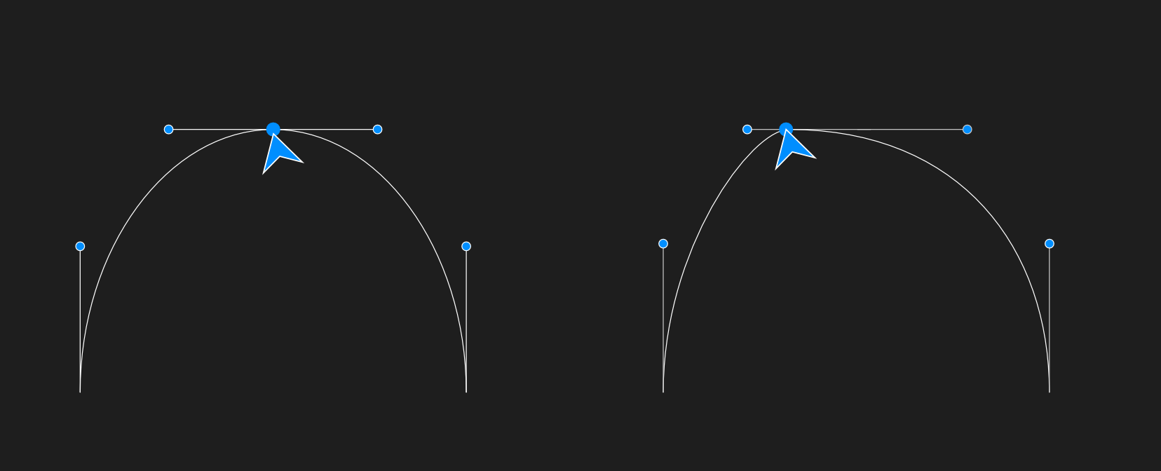

          After testing more carefully, I realized that most of the advanced bezier editing features we discussed are actually already available in VectorStyler (multi-handle editing, axis-based symmetry, etc.). Thank you for clarifying that.
          The specific behavior I am still looking for is shown in the attached graphic:
          The ability to move an anchor point without altering the direction or angle of its handles — meaning both handles remain fixed in orientation while the anchor shifts position.
          In the example image, the intended behavior is moving the middle node while keeping both handle directions completely unchanged, preserving the original curve tension and tangency.

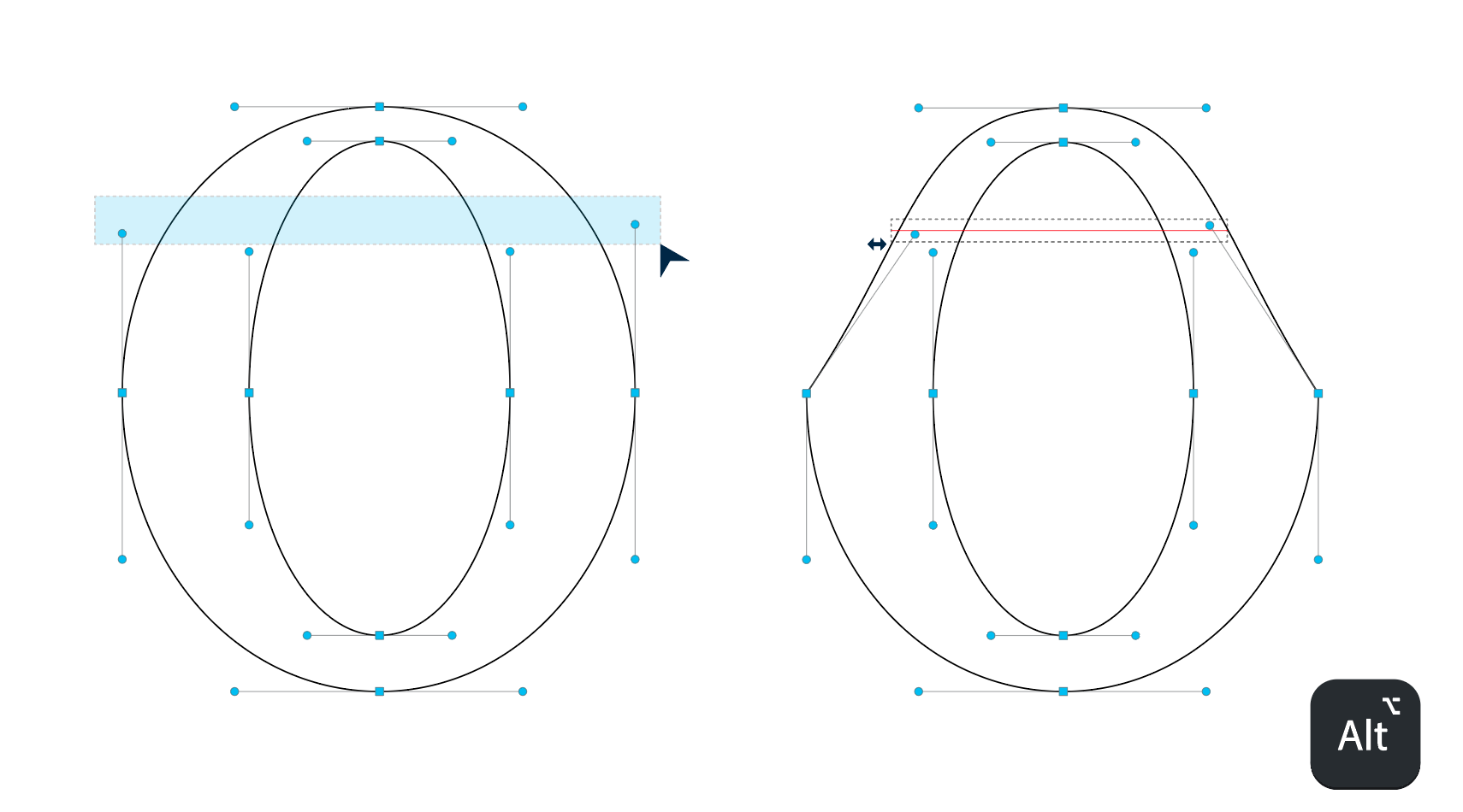

            Honor @Honor
            Parallel handle adjustment with a modifier key
            The ability to move two opposite handles simultaneously and symmetrically relative to their anchor, for example using Option / Alt while dragging.
            This would allow both handles to move toward or away from the anchor while remaining parallel, making it much easier to adjust curve tension without breaking the overall geometry.
            Left: Standard node movement
            Right: Parallel handle adjustment (Alt / Option) allowing both handles to move symmetrically relative to the anchor, providing more precise control over the curve shape.
            1. Marquee selection for multiple handles
            The ability to select multiple handles by dragging a selection area (marquee selection) instead of selecting them individually.
            This would make it much faster to adjust several handles at once during curve refinement.
