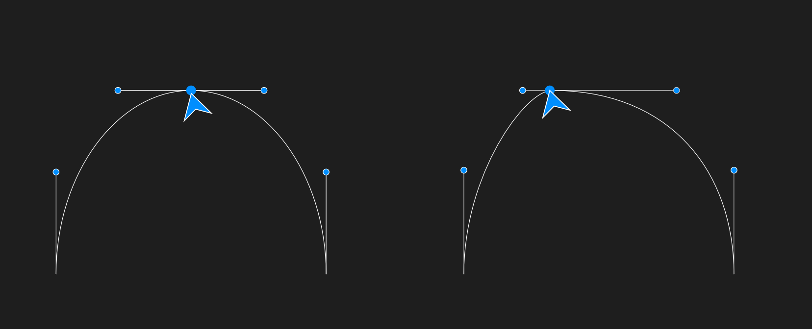

          After testing more carefully, I realized that most of the advanced bezier editing features we discussed are actually already available in VectorStyler (multi-handle editing, axis-based symmetry, etc.). Thank you for clarifying that.
          The specific behavior I am still looking for is shown in the attached graphic:
          The ability to move an anchor point without altering the direction or angle of its handles — meaning both handles remain fixed in orientation while the anchor shifts position.
          In the example image, the intended behavior is moving the middle node while keeping both handle directions completely unchanged, preserving the original curve tension and tangency.
