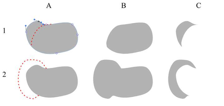

      This normally works as expected, but I can't get it to redraw the part of a closed path containing the start/end node.
      In example 1 A below:
      • the start/end node is the triangle indicator at the upper left of the grey blob shape.
      • the red dash shows the path of the pencil tool, attempting to reduce the area that contains the start/end node.
      • the wanted outcome is B. the actual outcome is always C.
      In example 2 A:
      • the red dash shows the pencil tool attempt to expand the area that contains the start/end node.
      • wanted B but always get C.
      It seems that the start/end node is untouchable.
      How to acheive this without resorting to Combine Path?
      Is there an equivalent to FreeHand's Freeform tool to reshape paths using an adjustable size?
      S VectorStylerV 2 Replies Last reply Reply Quote 1

          @Raven What was the direction of drawing with the pencil tool?
          Send me those shapes in a VS file, I will try to replicate it.
          • R Offline
            Raven
            VS file attached
            0_1767857815660_Redraw parts of a path.vstyler
            Looking at the Path Sketch tool now.
            tries...
            tries...
            Thanks Subpath. You are right - the Path Sketch tool can do this.
            I didn't know it can be used to modify closed shapes that were already created by other tools, eg Pencil.
            Reshaping using the pencil tool is still useful whilst in the process of creating shapes with the Pencil tool, to avoid frequently changing tools.
            Now to find an equivalent to FreeHand's Freeform tool.

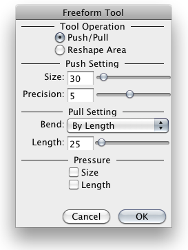

                @VectorStyler said in Redrawing part of a path with the pencil tool:
                Is this a 4-point transform tool?
                The Freeform tool is an adjustable size circle that can be used to "push" paths, in or out. It's destructive.
                It is similar to VS's Path Brush tool when used starting inside a closed path, adding area to the shape and smoothing the transition points.
                It can also be used starting from outside a closed path to push the touched area in, creating new nodes as required.
                I don't know how to do that in VS other than by using the Redraw with Pencil function, or now, the Path Sketch tool, but they both work by drawing the replacement path section - a different experience to simply pushing the outline around like clay.
                Have experimented without success so far with VS's Eraser tool, the Path Eraser tool and the Reshape tool. May be a setting or modifier key I've not found.
                0_1767868705176_Freeform tool help.pdf
                VectorStylerV S 2 Replies Last reply Reply Quote 1
