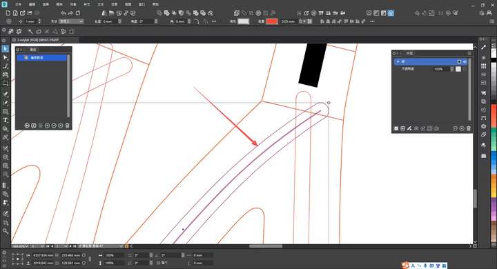

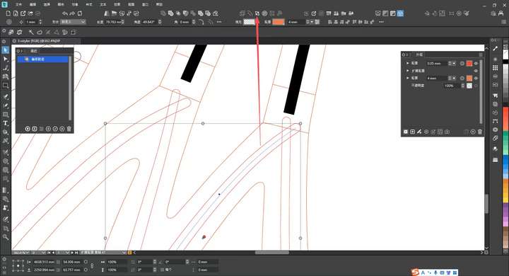

            @VectorStyler 0_1767451897614_mmexport1767451807898.jpg 0_1767451907730_mmexport1767451812578.jpg
            When expanding the path of this shape, a line will be left at the center of the original path. It is completely useless—can it be removed?
              VectorStyler @monsterfox
              @monsterfox I added this to the backlog
                @monsterfox Send me that example.
