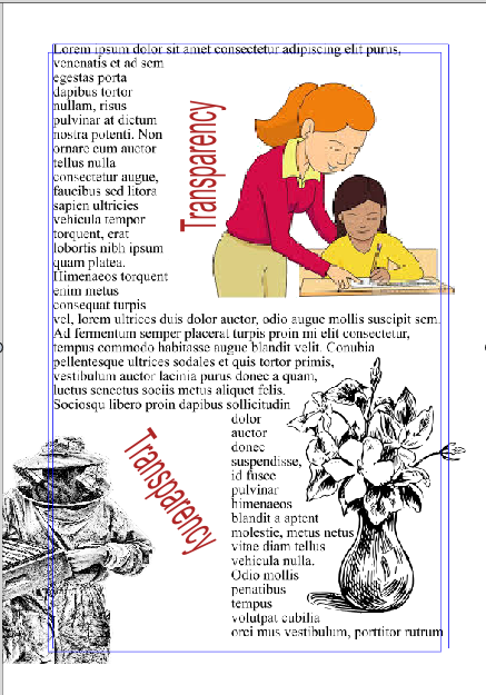

      Hi! Is there a way to wrap around an image with transparency? Normally in layout programs, transparency is used as empty space, and text use it for flowing around the image. But i see that in VS the image is squared, and transparency not used. I screenshot a transparent png and a svg, when you can see the difference in wrapping

        @marce No such option in VectorStyler. You need to draw a clipping path for now.

          Hi! I cant find how to make a clipping path in the manual, im not sure if you are refering to a line manually draw as contour or something else.

            @marce said in Wrap of transparent PNGs:
            Draw any shape, and drop the image inside the shape in the Layers panel.
            The Node tool can be used to keep editing these shapes
              Subpath @marce
              @marce
              Here a Video
              you could cut a shape (Ctrl+x) and put it per "Paste Inside"
              into another shape
              or like vectorstyler mentioned select a shape in the layer Panel
              and drop it onto another shape in the Layer panel
              the video show both ways
              to enter a clipping shape, if you like to edit the content
              double click at that clipping shape
              to leave that editing state double click anywhere
              outside of the clipping shape
              • M Offline
                marce
                Thanks VS and Subpath! Great thing the drag and drop inside a draw shape! Nice. Would be nice for bitmaps with transparency to have the option to extract automatically the contour for wrapping purposes.
