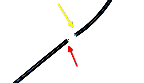

        Seems a bit curious, but one part looks like a path but isnt.
        Maybe because it is made with one of the curve tools ?
        Here a video with some description
        some pics
        yellow arrow seems made with a curve tool
        (you need to "convert it to curve" than the join will work)
        red arrow is a real path

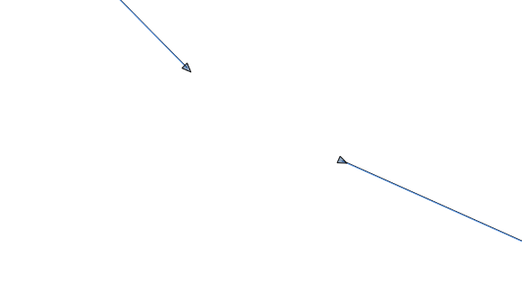

        here the ends of two "real" paths

            @Subpath thank you very much for looking into this. It makes perfect sense now that I needed to convert the spiral shape to curves

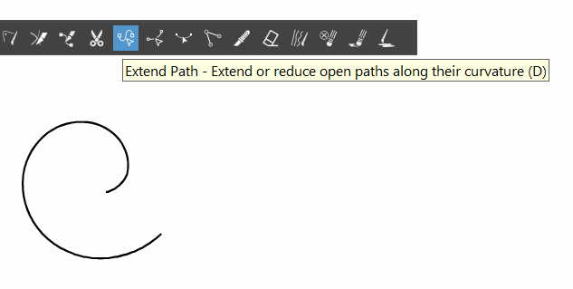

              Btw. the "Extend Path Tool" could also be helpful
              in some circumstances by working with Spirals
              (should converted to curves first of course)
