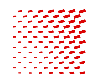

      mean you something like this ?
      then repeater > addional options > Adjustment Geometrys > Edit Adjustment
      may be a way

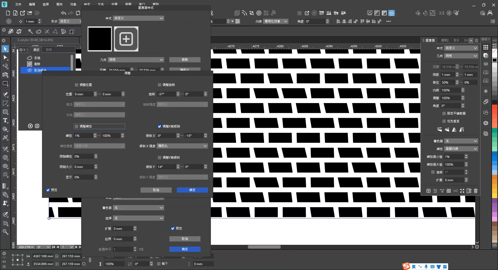

        monsterfox @Subpath
        @Subpath The effect is very similar to the one in your image above, but yours looks more like rotation rather than tilt.

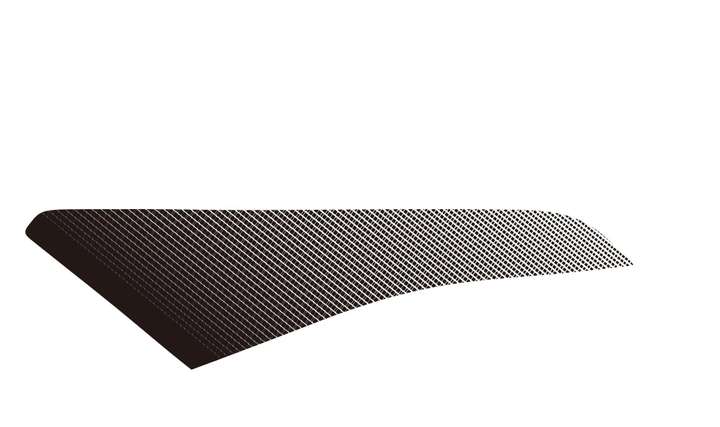

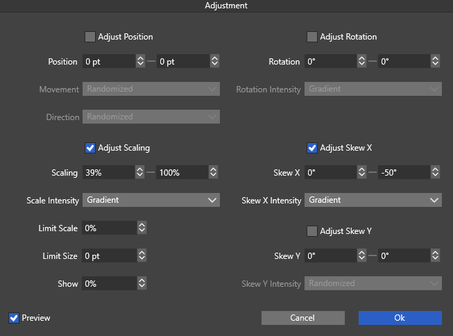

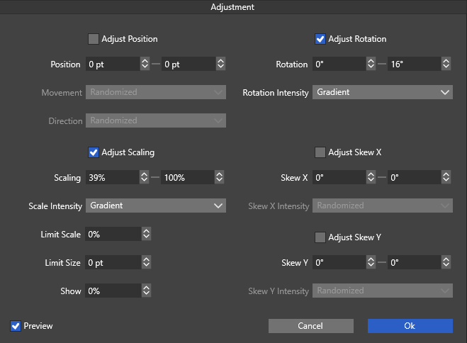

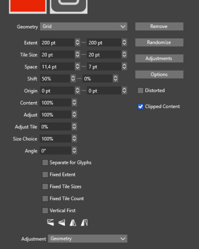

            had a closer look at your pic
            seems that Tilt is the same like "Skew" in Repeater

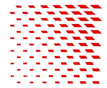

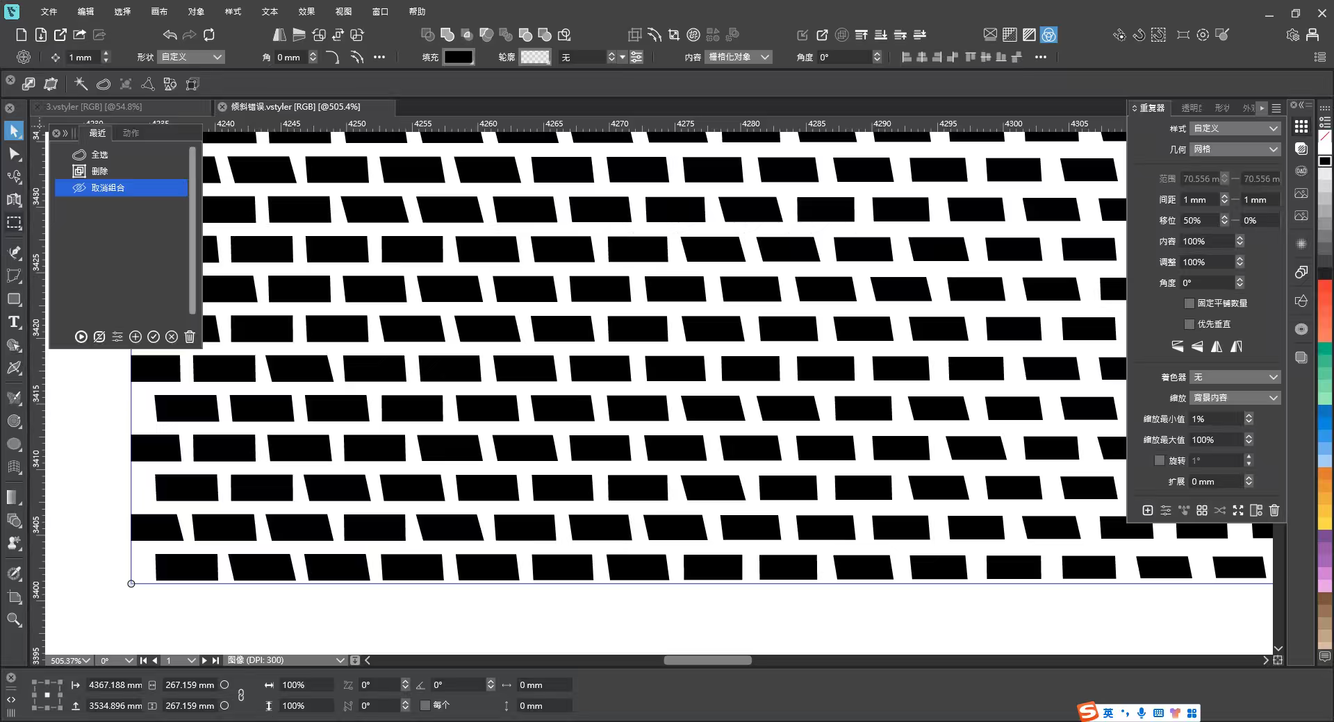

              forgot the repeater settings
              here the pic

                @Subpath Thanks! The effect of your image is quite similar. I'll test out the details tomorrow. There are still plenty of advanced features of the repeater that I haven't mastered yet, so I need to spend some time exploring them.

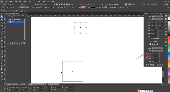

                      monsterfox @VectorStyler
                      @VectorStyler I enabled the skew option in the Repeater, but the skew angles of the repeated shapes are very inconsistent and messy—this should be a bug, right?
                      倾斜错误.vstyler
                        VectorStyler @monsterfox
                        @monsterfox I try to find out what can cause this
                          @monsterfox said in Queries Regarding VectorStyler 1.3:
                          The Skew adjustment was set to Randomized mode in the Geometry Adjusments. You should select Backdrop Content.
