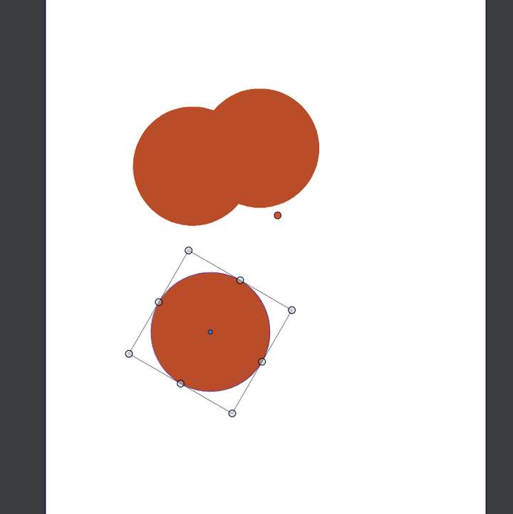

    I am sure this is a simple setting that I am missing, but I am after the quick 'rotate a shape around an offset pivot point', as demonstrated in this example (note I only referred to this post to avoid me making a vid):
    Re: Is there a way to transform/rotate shapes but with an offset?

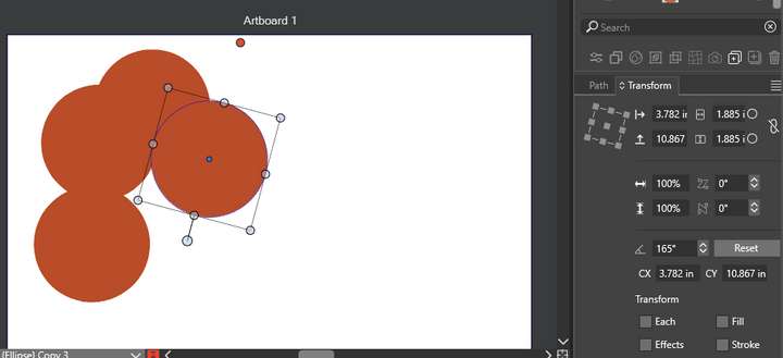

    I have created a circle, moved the pivot point to directly below it. Used the transform screen (Shift+Alt+R) to set a 30deg rotation, and use a copy, all looks good. When hitting Ctrl+D my shape and pivot point moves with each new copy. What am I doing wrong? I am very confused about the local transformations. Pointers appreciated.
    (and yes I know we can set the number of copies in that same transform - but I am clearly missing something here).

    I do not understand this part. So I have my circle, pivot point moved south, the pivot knobs in the transform panel deactivated. Set an initial rotation of 30deg and then using Ctrl+D is not giving the same result, as the pivot point rotates with the object.
  • administrators
    @syllie I think that rotation knob mode (the handle on the selection frame) causes this issue. You can disable that from the context panel (the transform tool options icon).
    I can also replicate this issue here and I will try to fix it ASAP.
  • @VectorStyler Oh! interesting. I only enabled that to make testing of your first approach easy. Without that rotation knob, and the pivot point knobs in the transform panel deactivated, it works exactly as you said. Thanks for getting back on this.
