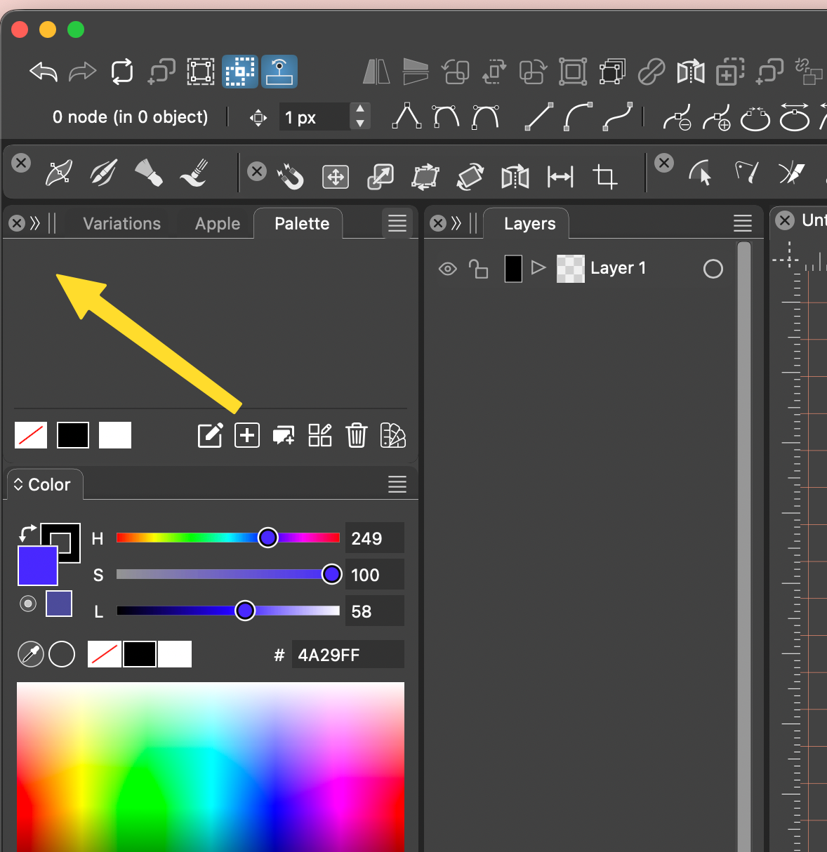

Hi
The color samples are no longer available and it is no longer possible to add new ones.
What happened?
Thank you

@Fertuffo Try closing and reopening the palette panel. If still empty, save that document and send it to me (palettes are in the VS document).
Also: it could be something with the workspace. Try backing it up and reseting to default.
Resetting to default solves the problem, but loading my custom workspaces reproposes the error
I attach my file
@Fertuffo Can you send me the workspace files by email? Thanks!
@Fertuffo This can be replicated, the fix will be in the next build
@VectorStyler Ok, thanks
@VectorStyler Latest build fixed the problem. Thank you so much
