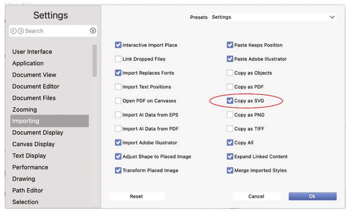

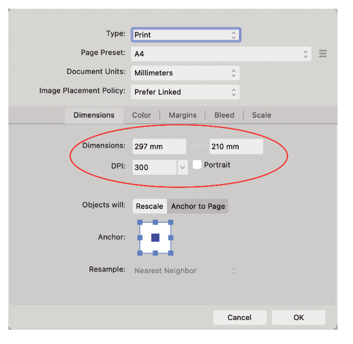

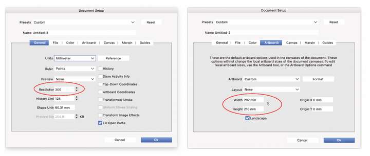

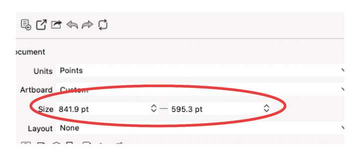

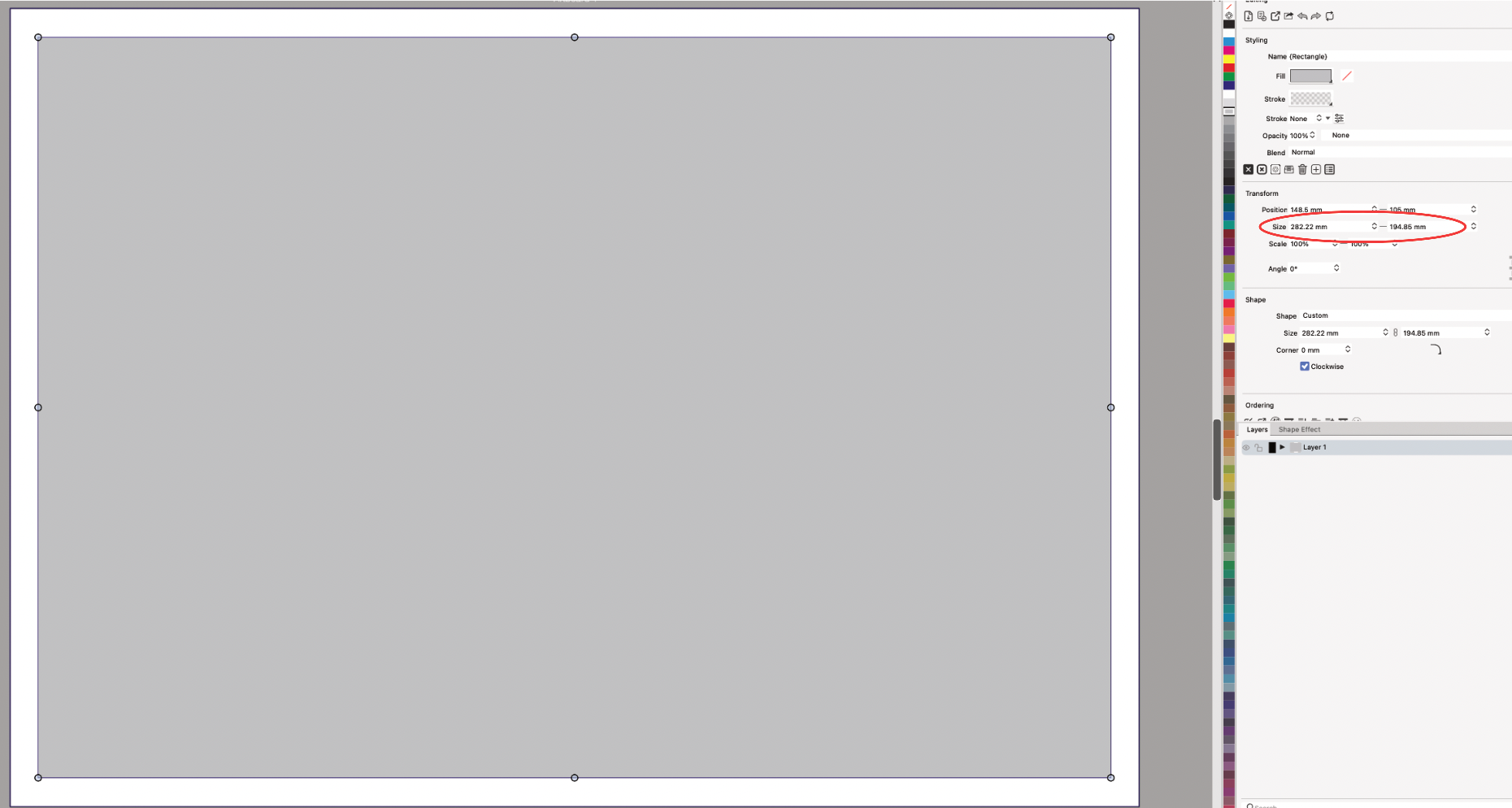

I'm trying to copy paste shapes between VS and AD and could not find a way to preserve object size. Is there a setting I need to apply for size to be preserved ?
VS
AD

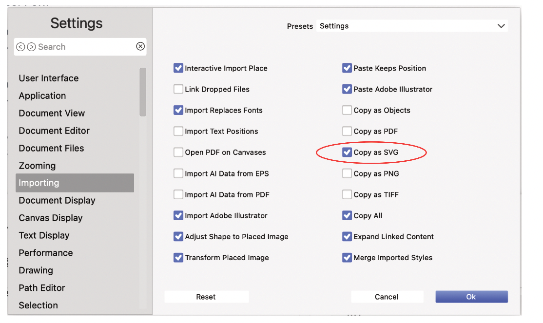

@EricP Did you try the copy / paste with PDF?

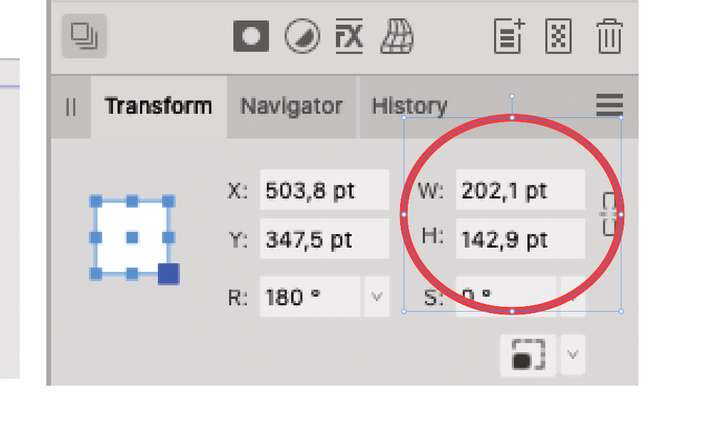

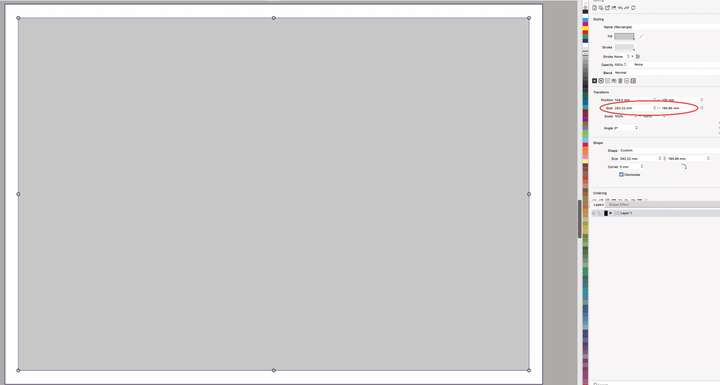

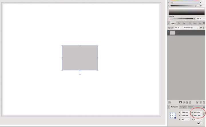

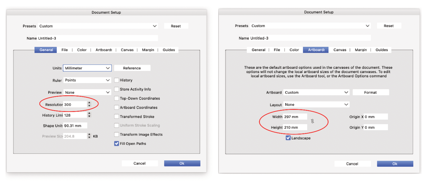

yes I did, but position is no longer honored when copying layers separately (all individually aligned to the top left corner) and group structure is lost.
I think the issue is more on the AD side as the copied svg string has the right dimensions, but they change once pasted in AD
