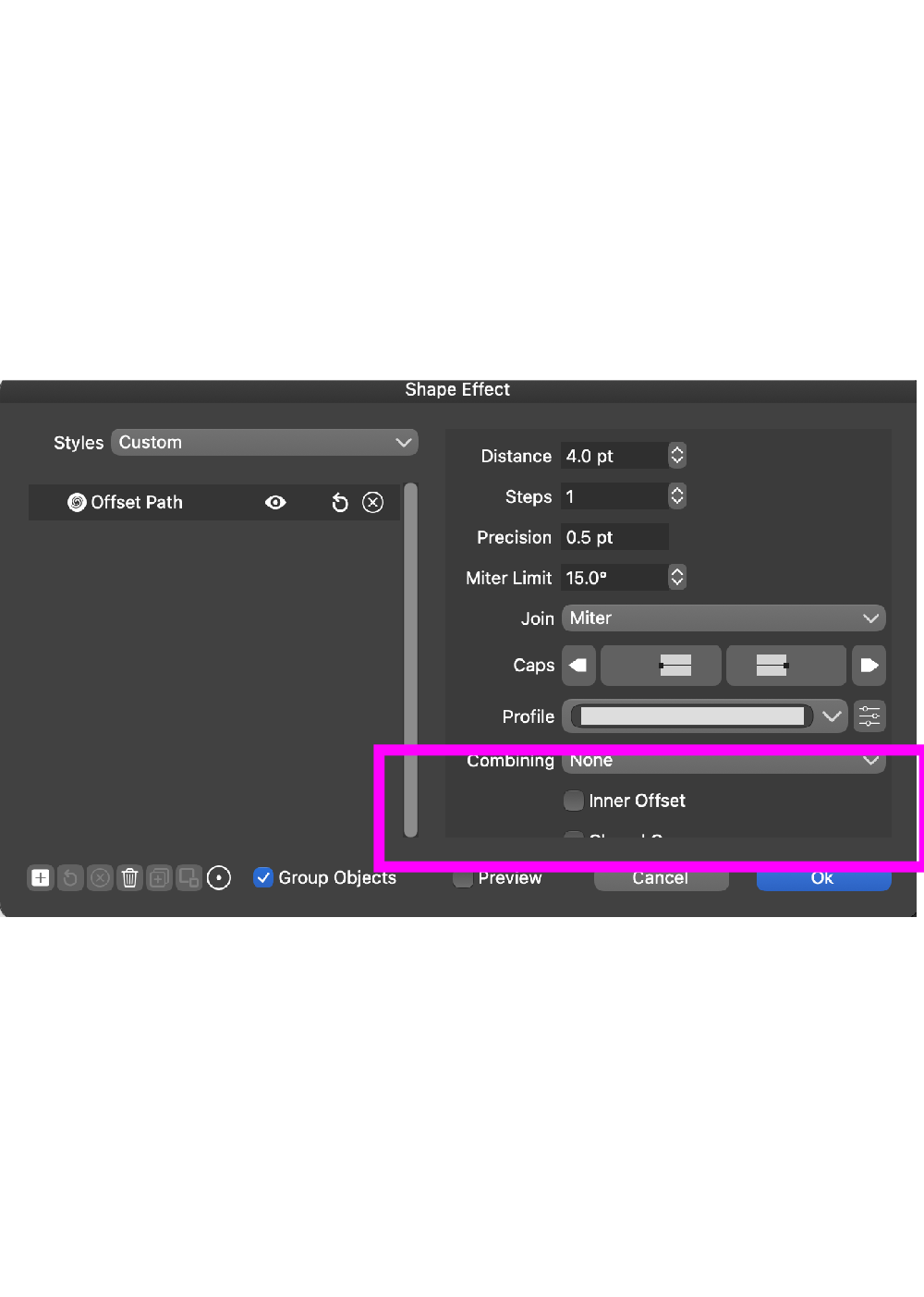

      Not really a bug, but, you may want to adjust this:
      I noticed that when opening the Offset Path Effect Panel (Effects>Outline>Offset Path) the first time (or after Workspace->Restore-Default), it does not reveal the entire Panel vertically (cuts off the items listed below the Inner Offset) like this:
      0_1622106314224_Offset-Effects Panel_No-Fully-Opening-Initially-Vertically-by-Default_Annotated_Screen-Shot_PNG.png
