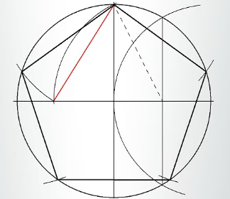

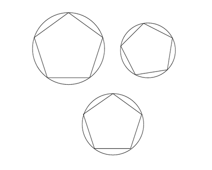

I wanted to do this accurately and I couldn't.
Don't know if this was what you were looking for (see picture),
but if so, here are a few options I found
@Usuario Some shape properties can be manually entered in the Shape panel. For example to set the circle and polygon radius to the same value.
Also: alignment might not help in this case, but using Collision snapping could place the polygon to the right position (if its radius is the same as the circle).
