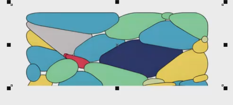

Unexpected Result doing Boolean Exclude with a Bitmap
As the title suggests, cutting a bitmap with a rectangle deforms or
resizes the bitmap instead of cutting off (clipping) the corresponding portion.Here's a video demonstrating this in VectorStyler and CorelDRAW.
CorelDraw
@Subpath Yes, this is a known issue.
A workaround: place the image into an other clipping shape (can be a rectangle of the same size). The image can be drag&dropped into this clipping shape in the layers panel.
Then use the boolean exclude on the clipped image. This will exclude from the clipping and not the image shape, so the image size will not be changed.
