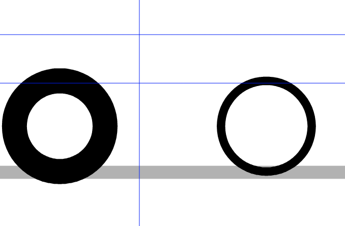

Another problem, in this same layer. When I convert a copied circle to curves, it's outline seems small, but still has 15,1 pt thickness.
I just see Styles Custom
It means that there are no shape effects on the Layer (which is good in this case, because I do not see any).
This one is an issue with the displayed value. It seems to be a bug, I will fix it.

So how do I apply definitly this tranformation to the objects in the group? I selected it and tried "reset" in Transform.It is not only the displayed value, as you see in the capture. Before the conversion, the circle size is 33,33%, so I presume this is the problem. Is there an option to keep the thickness when using the button?
