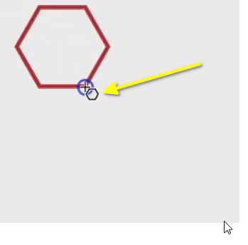

    To top it all off, it would be nice if this little icon
    here could also indicate the change. See Picture.

    If the small indicator icon (in the picture above) would indicate such
    a change in the future, I would find that helpful. However, this is by
    no means urgent and only if it is possible
